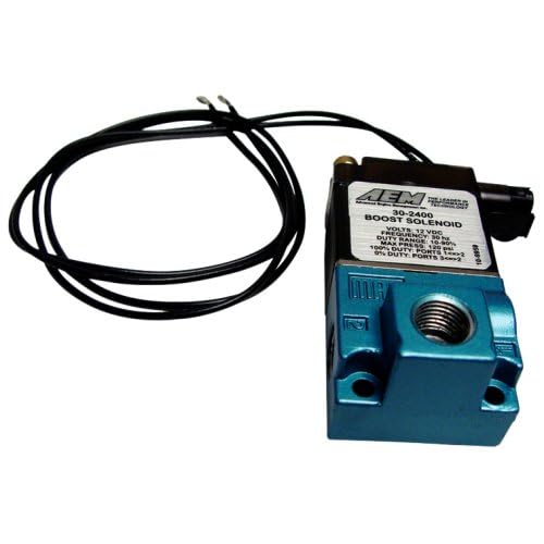

Sorry to bring this tread back to life. I used the search function before starting a new thread and found this.
I have the AEM Boost Control Solenoid w/ out the gauge along w/ the AEM EMS V2.
My boost is currently controlled by the EMS @ 14psi.
I also want to have a switchable boost level.
From the AEM Boost Control Solenoid in the engine bay I traced the wires thru the firewall and one wire went to the fuse box above the ECU and the other wire went into EMS Connector D16 --- PW 2 Output Avail, Boost Solenoid Output.
If I disconnect that wire does it cut off the Electric Boost Control which is set @ 14psi via EMS and drops the boost down to my 10psi wastegate spring?
If that is the case, do I just wire a switch from that wire so I can make the boost switchable from wastegate 10psi to 14psi?
Also, if possible I want switchable boost levels from wastegate 10 psi / low boost 12 psi / high boost 14 psi. How can I make this possible?
Thanks in advance!
