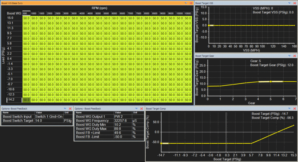

Switchable boost levels with AEM EMS

anyone???

Here you go...
Boost by gear starting at 8 PSI and ending at 12 PSI. Horn button is sending a ground signal to Switch #1 activating a 14 PSI target on command. This particular setup is using a .5 Bar wastegate spring.
You could also set up a simple boost by switch position using AEM's trim switch as the input for gear position. Just reach over and turn the knob to raise the boost.

Is it possible to have different boost psi using aem tru boost controller and aem ems?
yeah,the AEM Tru Boost Controller comes w/ a gauge. It has selectable boost settings with a push of a button i believe. I don't have the gauge so I'm trying to figure out how to do it w/ out it.
