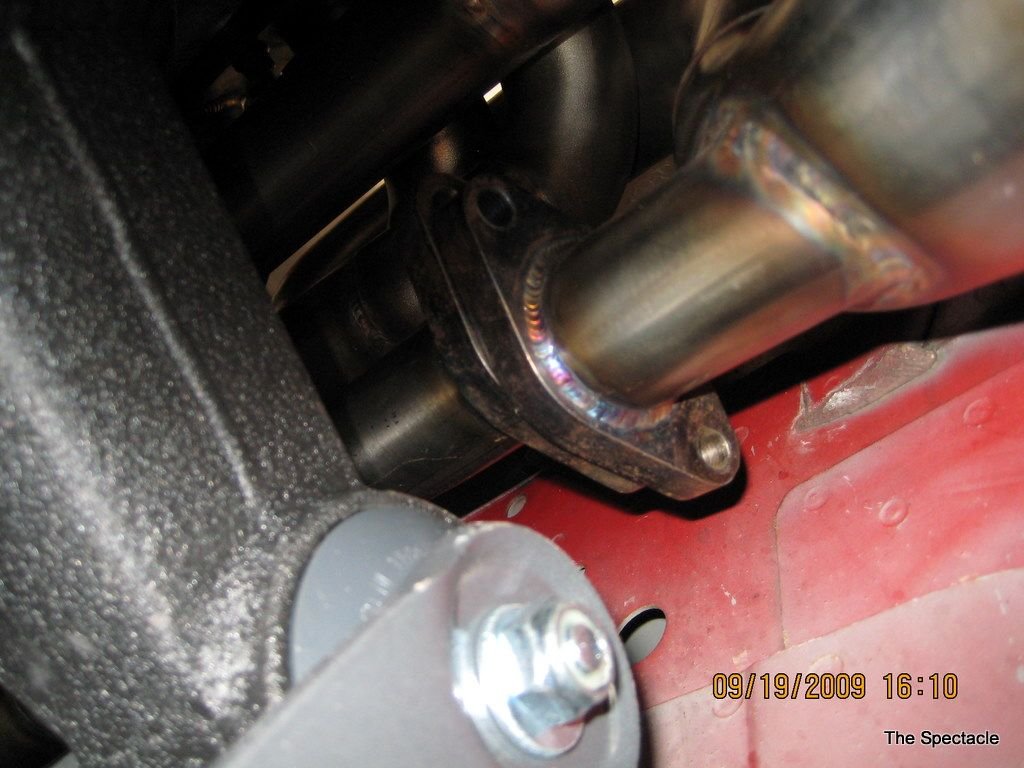

Mine is recirc'd. Here's some bad pics. Cost about 10hp and a significant amount in the midrange, but it so much better sound IMO
