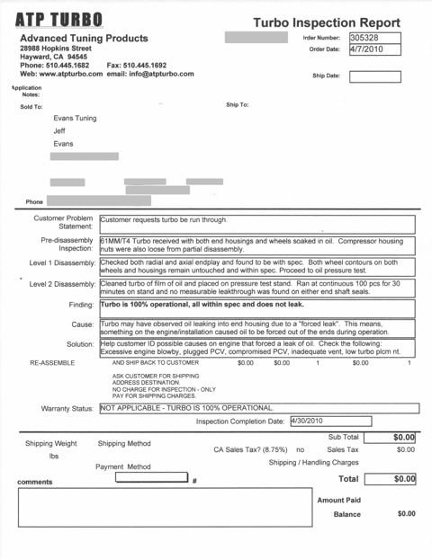

no, just oil lines to turbo, turbo is bad according to shop (shoots out oil), but there is no coolant going to it
Old Apr 11, 2010 | 10:33 AM
DFWs2k's Avatar
Joined: Oct 2005
Posts: 14,614
From: Denton, TX
could a turbo that is bad from the factory (i purchased it brand new and it was shooting out oil as soon as it was installed), cause this? or does it have to be something else, too?
engine was great before turbo kit install, turbo kit was installed, turbo started shooting out this stuff and oil
