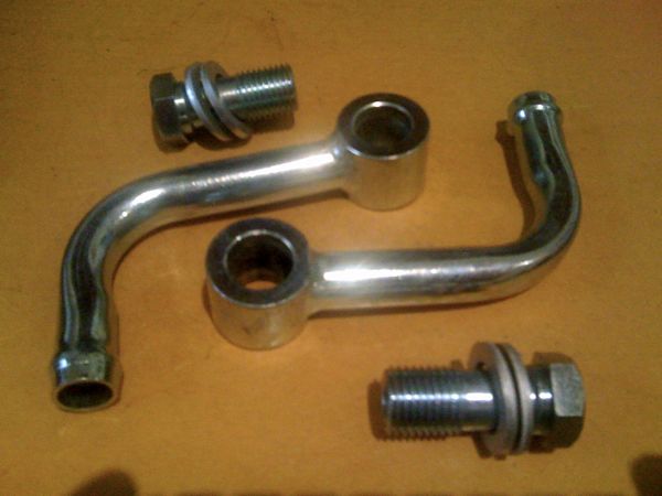

Are the lines getting too hot? Are they suitable for hot coolant?
I had rubber lines going to banjo bolts on the turbo. There were too close to the turbo and would deteriorate over time.
I fixed the problem by using extended fittings:
These move the rubber further away from the hot turbo and greatly extend the life.
