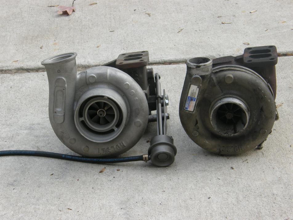

That's a 7670? looks a lot smaller than mine. Should try to make it fit with the waste gate, boost controller and recirculation valve on. Keep in mind that the core needs to be clocked a certain way, and so will the compressor housing. The waste gate mount may not end up being in an usable position. Where your turbine housing is located, the Waste Gate will be at the oil filter. The guy that make my manifold and myself spend 2-3 hours trying to make mine fit in a bottom mount location.
Props to you if you can make it fit, though.
Wish I managed ... Well as I told compressor on photo is same size as 7670's. I thought compressor running into a frame is what makes it no go. Core should position free, housings and wg are linked, and I believe compressor housing is free to turn as well. Wastegate ... I hope it is possible to elaborate the rod and wg mount so it goes around things... It may be as long and twisted as needed so far it is sturdy enough not to bend.
Still buying 7670 just to face the fact it cant be mounted wouldn't be pretty.

Originally Posted by ninetysixyenko
this is a good picture to show the enormous size of the EFR turbo.. and this one is single scroll.
http://s158.photobucket.com/user/sil...xtall.jpg.html
Wow! Quite a difference

Compressor housing clearance width wise wouldn't be an issue. Length wise it will be, look at the picture posted and see how much longer the EFR turbo is, that moves your compressor up to the oil filter area. Core does rotate freely, but you will have to take into consideration the Coolant lines for it. Compressor housing also rotates freely.. to an extent, it has to be rotated ~15* at a time to allow the waste gate bracket to still align correctly. Waste gate and rod rotate with the turbine housing, with the way you have the turbine housing sitting, it will be where your oil filter/cooler sits, and a relocation will not help.
Originally Posted by herecomesboost
Yea, it's actually quite impressive on how much larger and heavier the EFR Turbos are. Well worth it though, in my opinion.
You're also comparing an EWG turbo vs an IWG turbo. They're shorter when you don't use an internal gate housing.
