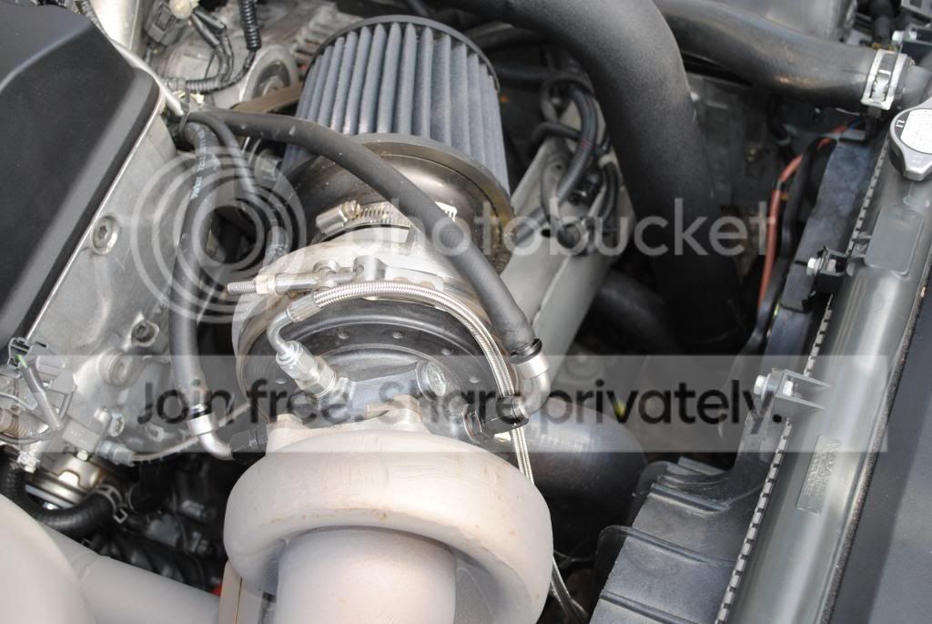

The first coat of KBS Coatings Xtreme Temperature Coating applied. Now I have to wait 8 hours and then bring up to operating temperature so the resin activates...then I can apply more coats...probably apply at least 3. They have several colors to choose from and since they have no purple...I went with Charcoal Metallic...it is almost identical to the original color of the metal.
That looks great!. I will absolutely be using this on my turbo.
