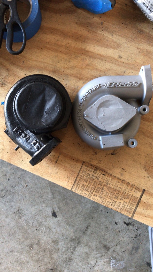

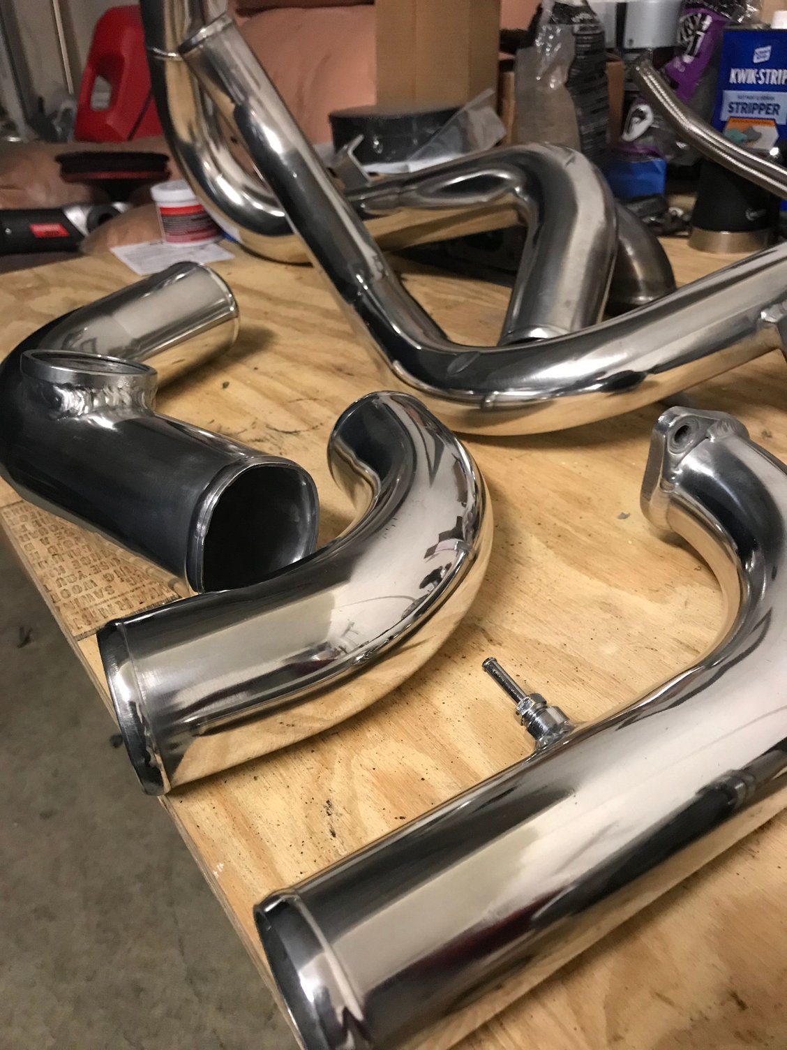

Some small but quick updates. Stripping and polishing IC pipes took awhile. I have OCD about the small dents and did my best to take most of em out.
Also painted the compressor, turbine housing, and downpipe and baked it to cure. Next it’s just heat wrapping the downpipe and possible the manifold and we’ll be set to install.
