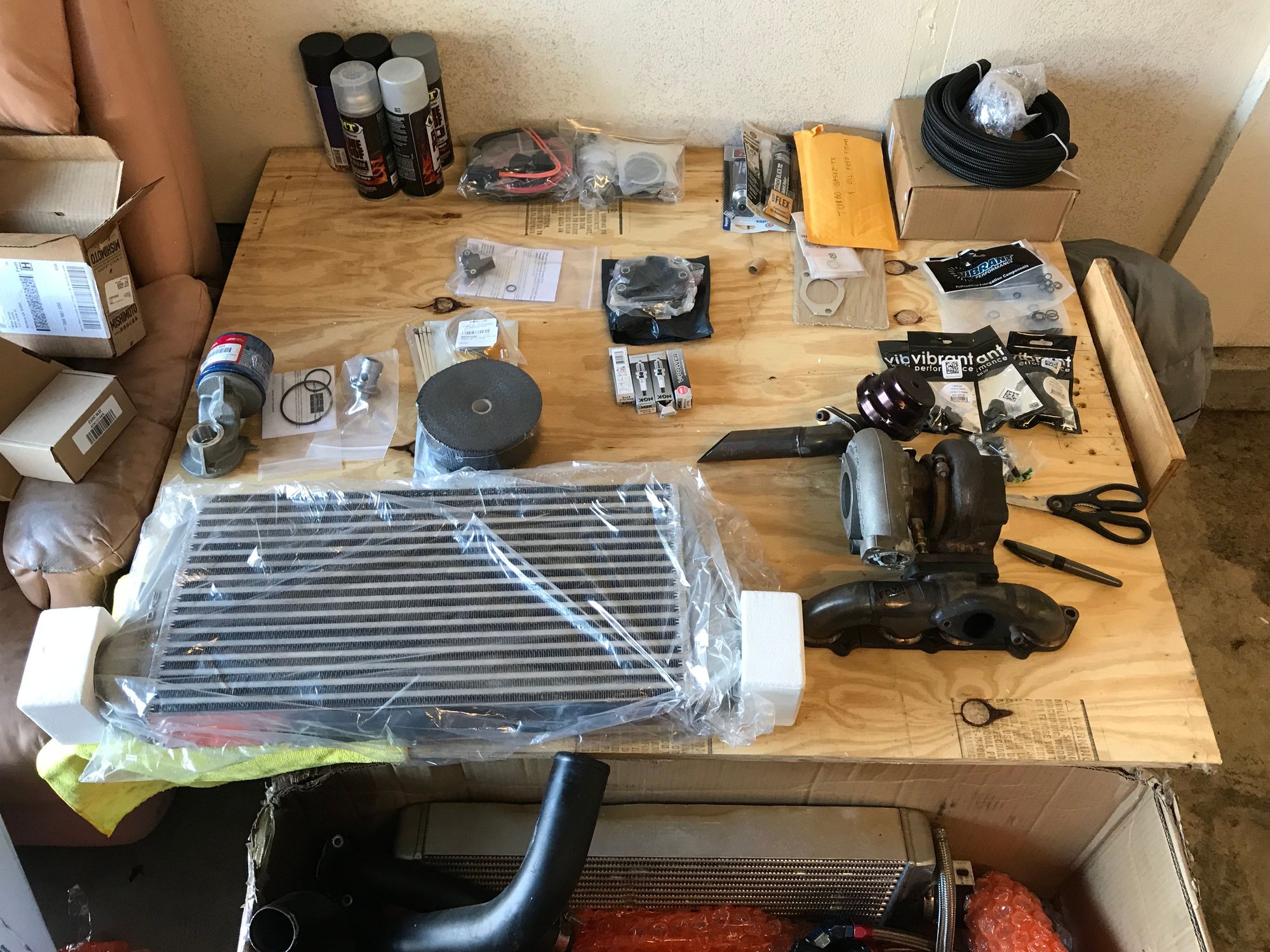

So you can imagine the list of parts that I'm about to plunge into. You can go into the Google Sheets to see everything I've purchased (highlighted green). As of now, none of the parts have been installed. I will be doing the install myself since Greddy has great installation instructions. I'll explain the upgraded components as I go along with the install. I'll most likely be sharing the progress in my Instagram as well @swolepanda_s2k
In the meantime, here's the build where it currently stands

Here’s what we’re working with so far. I have everything listed on the excel sheet except for injectors(delivery signature was required and I wasn’t home) and gauges.

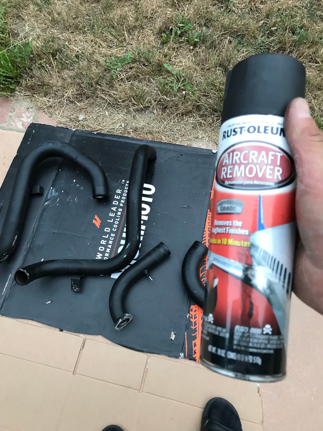

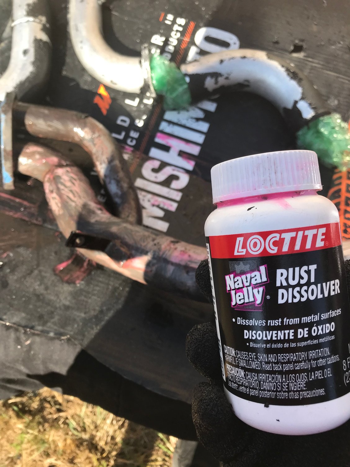

I’m starting by stripping all the paint from the intercooler piping and sanding it down. Haven’t decided on painting it or polishing. Also removing all the rust from the downpipe and manifold for heat wrap and high temp paint.
