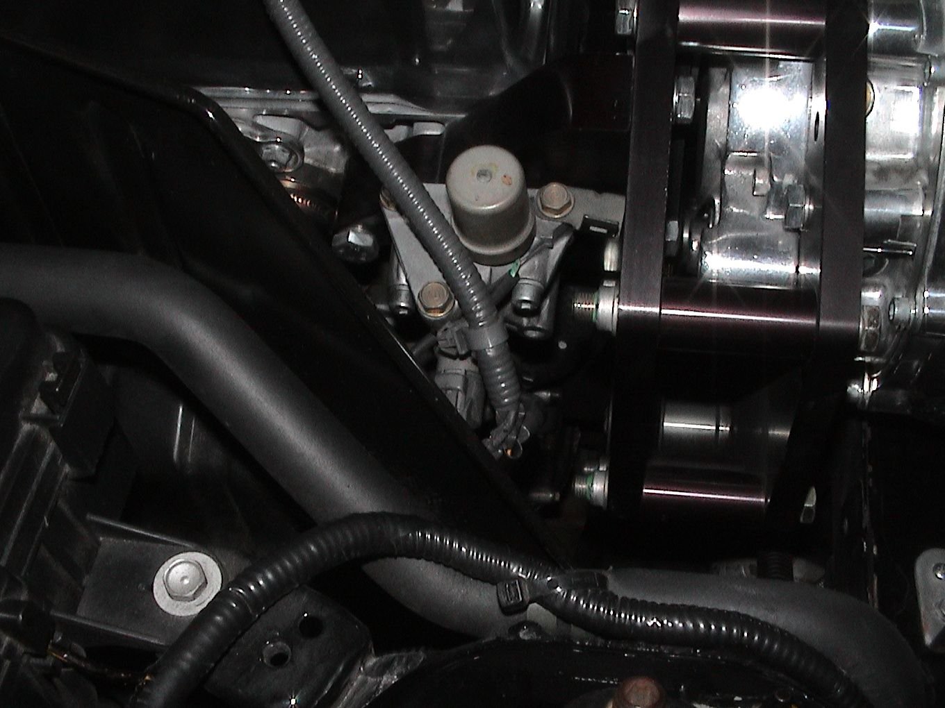

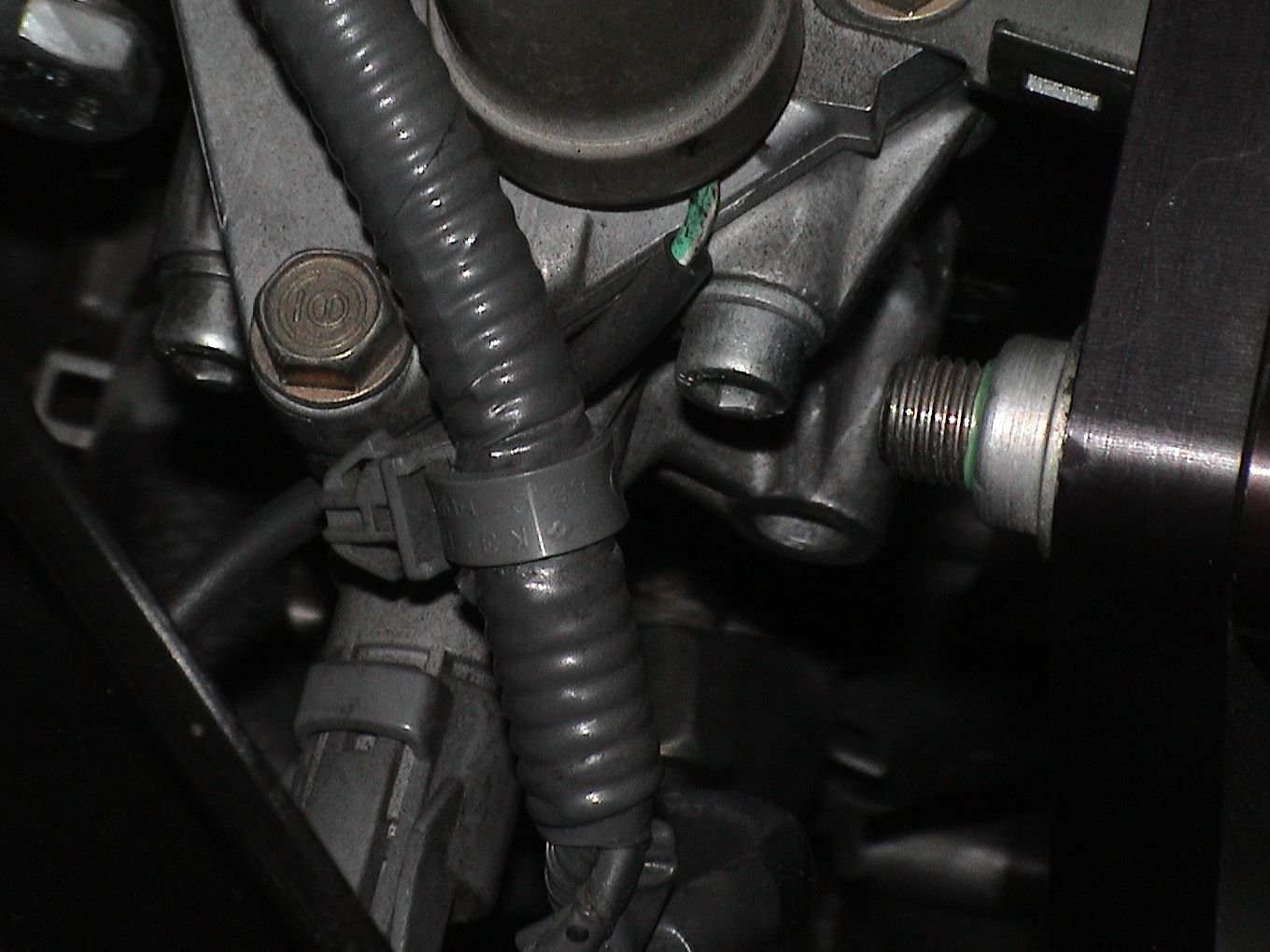

Well, after giving some people a hard time about this subject, we found a broken Vtec solonoid bolt on my car today. I can see the end of it in the head but it is broken off flush or slightly in the head. I may need to easyout the bolt end from the head and since there is very little clearance, it looks like a major PITA. I'll post pictures in the next post.

Notice the allenhead bolt on the right and the empty hole under it.
Close up
One potential solution, Titanium bolts.

Did your car come from the factory with allen headed bolts?
If it is broken off flush with the head, I have had good luck with wire welding a smaller bolt onto the end of the threads so that you can back them out with a wrench.
