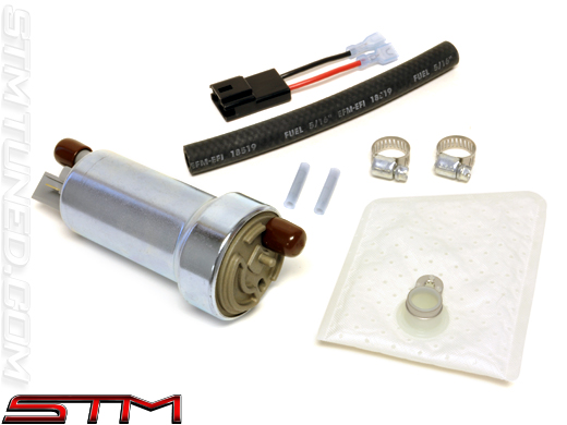

I believe the install kit I had was the universal kit, I will see if I can confirm this by looking at the packaging it came in when I get chance. Regardless, the sock filter you need to use looks like this:
