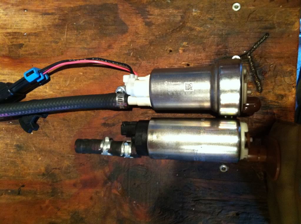

Thought I should post some pics of the install of the E85 version of this pump. Hope you don't mind spectacle.
Comparison between walbro 255 and 400

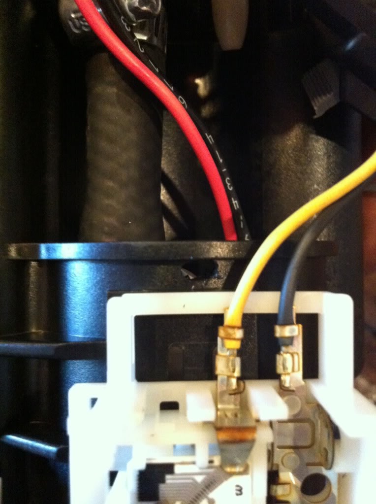

Hole I drilled so I could run a zip tie through and secure the plug. (This plug is specific to the e85 version of the 400.

Keep in mind passing the wires through as you show is not recommended as the fuel can wick through the stranded copper wire in the insulation. While this may be a minimal amount of fuel, the concern would be the small amount of fuel turning in to vapor and igniting from spark of electrical components (such as the relay). A hermetically sealed connector (like what the factory carrier uses) is recommended.

How do u route the wire? With this pump your have to route a bigger wire from the pump to outside the fuel pump housing. How can u do this with out drilling the top of the housing ?

anyone have an answer as to how to wire this hard wired outside the pump using all new wiring? I want it to be safe, and not allow fuel up the copper stands of the wire ... anyone ?

Depin the connector on top of the housing replace the wires with your new one. I'll post up the pictures I took here shortly...I keep forgetting to do it.
