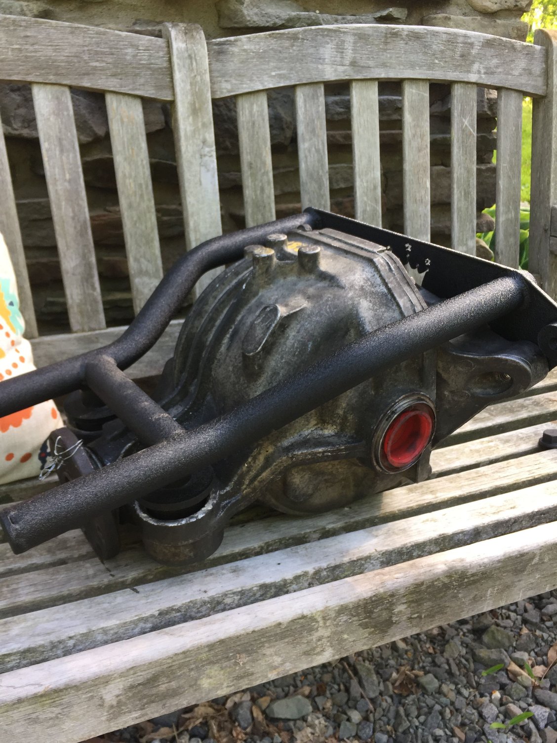

Apparently his jig differential housing isn't the same as my new one from ford.
It is tight on the inboard sides of the front mounts. And it also had about a .050" gap on one side (the 2 front mount flanges aren't straight with each other...one is slanted. The machined area on the diff housing are flat with each other.).
He offered me a chance to send my housing in to get a cradle made to fit.....but I can fix it just as easy at home....and I won't have to pay to ship.

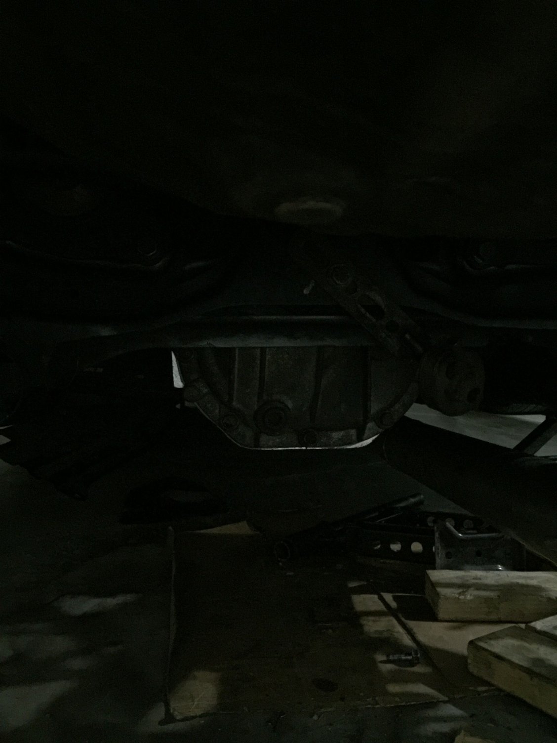

I got a used rear from a 2007 Explorer and it fit no issues
Old Jun 26, 2017 | 08:27 AM
2004TurboS's Avatar
Joined: Jul 2013
Posts: 196
Before I bolted or ground anything down. Also added a brand new Ford racing limited slip with carbon clutchs myself. ( only $220 brand new shipped )

Bolted up

the mount is only designed for the 2007-2010 explorer diff. it will not fit the thunderbird and cobra 8.8

Here is a pic with the driver side tightened flat.
And a pic showing the slanted mounting flange area. The housing from ford is machined parallel at the top of the mount "cups". And it fit the same way on a 2006 explorer rear end I bought at the junkyard.
The pinion on my junkyard rear end was seized either to the bearing, or to the companion flange. It wouldn't budge even with a generic 20 ton press. Which is why I bought a new one from ford.
Buying new, the price for all the parts is around $900-1000 with a 03-04 cobra differential. And the inner pinion bearing is different than most of the 8.8 bearings. It is a 3.54" outer diameter race compared to a 3.25" (correct bearing part number - 6L2Z-4625-AB / Koyo ST4190).
