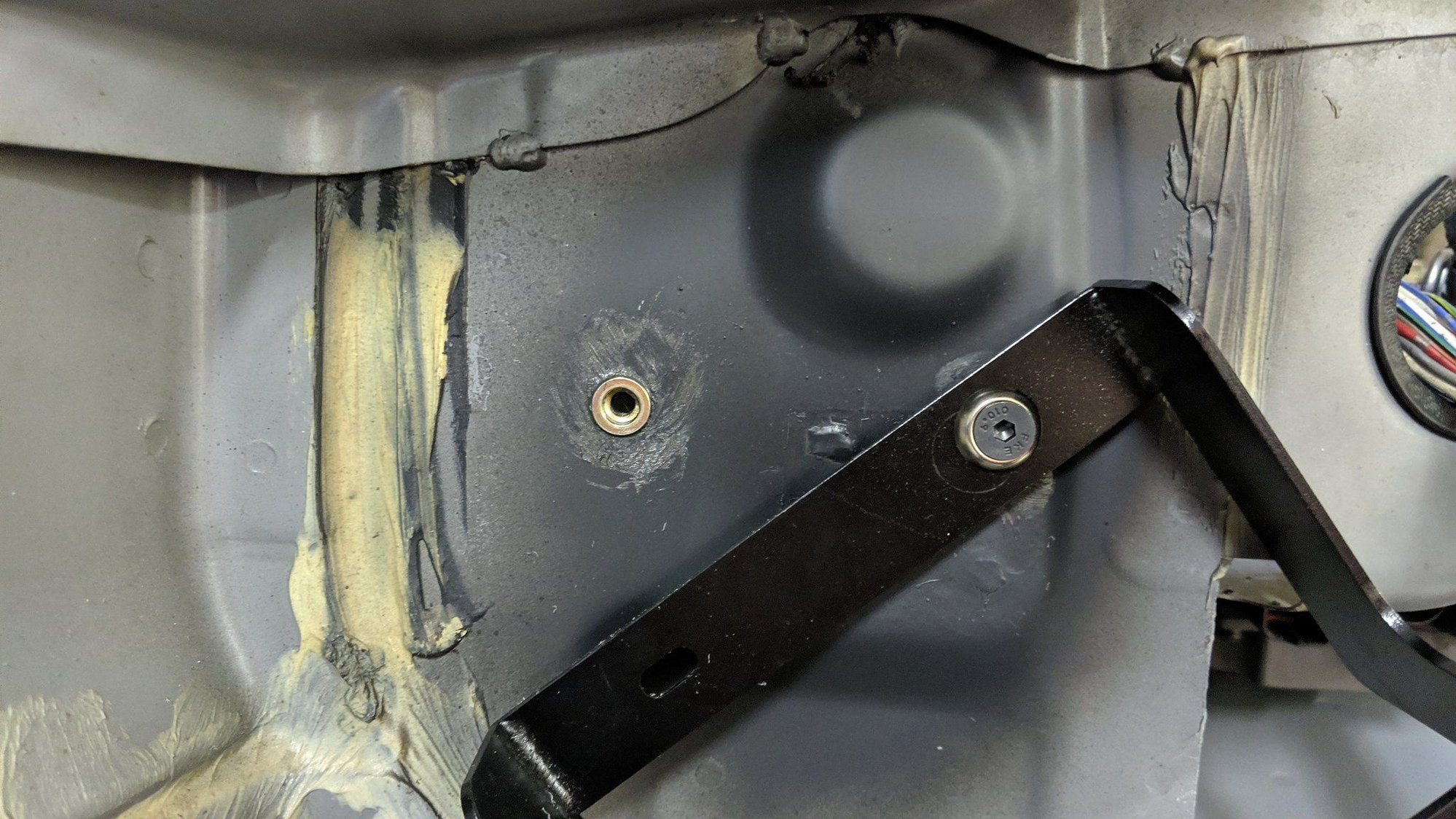

Wanted to share my install of my XPerformance fuse box relocation. Couldn’t find any good pics online so I thought I’d share what I had to do to install it. Overall highly recommended!!! Loved how it turned out.
You need to remove the windshield wiper fluid mount in the passenger fender. Bend back the mount far enough so that you can reach the 2 spot welds with a grinder.
Grind flush and then paint over raw metal (I only had white

I was going to buy that kit, mainly for the eps relocation, but wasn't going to spend $99 on it, plus I want to keep my washer bottle. Nice to hear that it is a good option though for those who don't mind losing the washer. I ended up making my own eps bracket.

I don't remember grinding my bracket off... Pretty sure I used a chisel or screwdriver.
