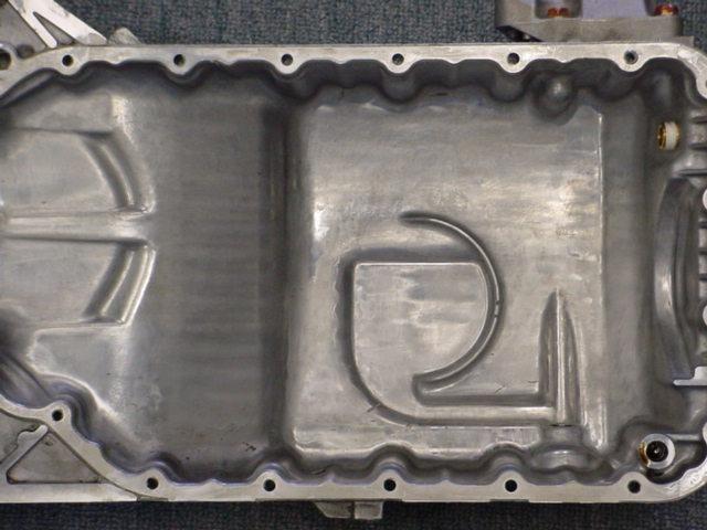

Requested Oil Pan picts:

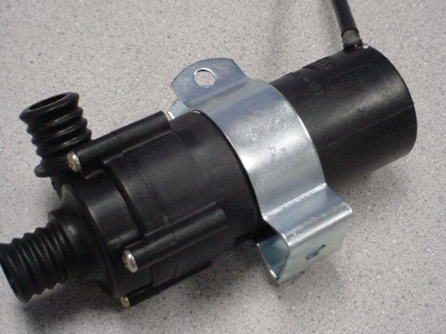

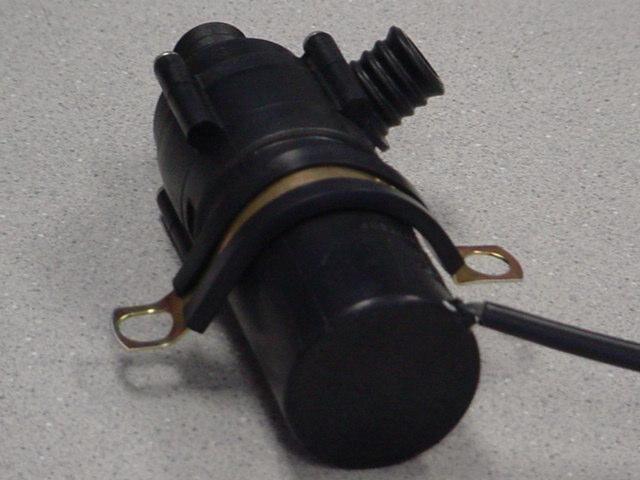

One other issue we have found is that the clamp to hold down the water pump does not fit all the way around the pump itself, so we used a clamp from Home Depot. For those of you guys who have ordered your Vortech kit from Evolution, we already have all the necessary fixes and parts for your kit ready to go. So have no fears. I hope this post helps everyone else with the install, again if you need help give us a call. I'm heading back to the shop to get back to work. I have a dyno available this afternoon if I can get to it. Unfortunately there is mad traffic in the DC area on Friday night and its raining here.

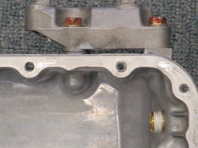

hmmmm still if the oil level is not up to the pickup point for the supercharger, the supercharger will be just sucking in air instead of oil right??

Yep Ran into the clamp issue today as well. Also missing one of the L brackets for my watecooler. No biggie on that Its not going anywhere. Stay tuned to that link for more pics and movies of the install. I will post a detailed description of the install and who I think shopud try it. This also depends on how much it would cost to have it installed of course. I just like doing my own stuff.
that line tapped into the pan should be the drain line, the pick up line will be coming from elswhere.
