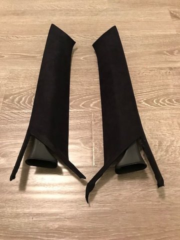

Easy to do, just depends if you want to keep the "bumpy" textured look or not. If you sand it down it is very difficult to get that look back. Make sure you use a good primer meant for plastic and you should be good. The only issue with paint is that it starts to fake off in a few years and is not very durable long term unless you are very careful. What panels do you want to paint? You could also warp panels with various fabrics, I did a lot of mine in alcantara and love it. I always thought the plastic looked cheap but love my S2K like no other car I have ever had. I have had some really nice cars but always found the S interior needed a bit more to make it upscale. Here is an example of wrapping a panel (these are my window pillars, easy to do and lasts much longer than paint.
