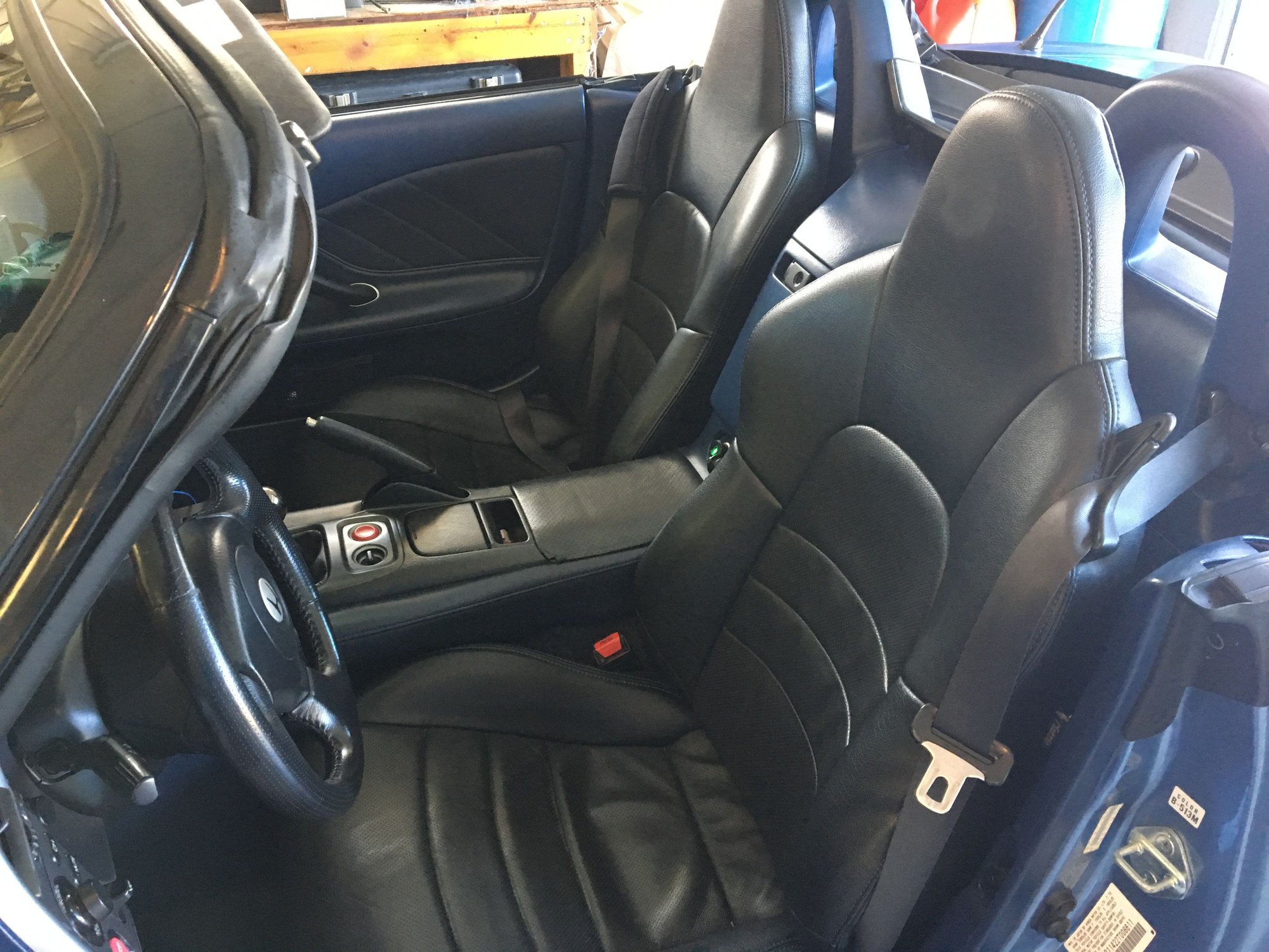

I did this several years ago and followed pretty much the same process except that I bought high density from from local regular upholstery shop and cut out a fairly large arc constituting most of the bolster, itself. The bolster was formed to a size slightly larger than the original construction. The bolster was then fully covered with a plastic sheet made from a supermarket plastic bag to allow the bottom cover to slip back on efficiently. Amazing result! Six years later it looks like it did on the day that the work was done.
The photo below is from this summer when the seat belt guide was being replaced. Still looks new!
