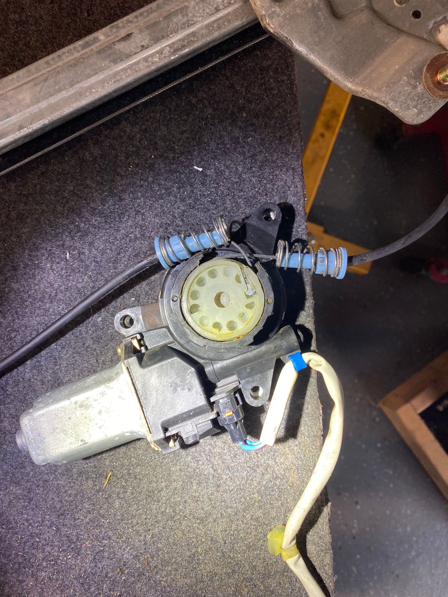

Here is the passenger side full window regulator removed with old motor (in the picture the white plastic retainer has already been removed) notice the orientation of the motor:
Here is the regulator with new motor installed, the orientation is 45 degree offset:
The motor didn't need any modification to fit the pulley system, I'll post some pics of how to de-pin and swap pins in the next few days, the connectors were identical to OEM connectors.

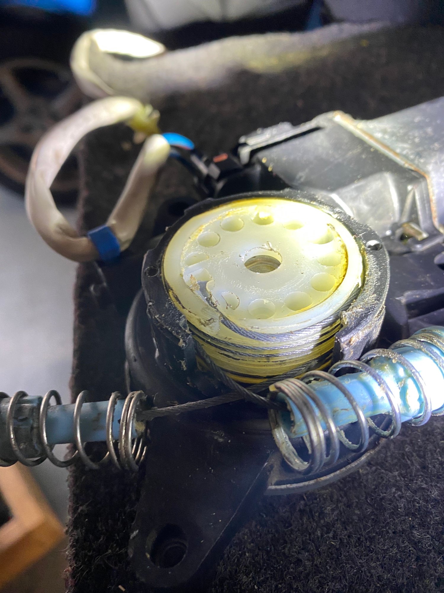

I've got a rebuild kit for the passenger regulator for my S2000 (2003) and for the life of me, I am having a tough time winding the new cables onto the spool that fits over the gear on the regulator motor. Anyone seen/have a link to a either a video or really detailed photos on how to do this?
THanks in advance.
Dave

Here is the most detailed photo I took of the spool assembly, the white plastic retainer can be difficult to get on as both springs are under tension at that step and you have to compress the springs as much as possible to get the neck of the blue locking retainers into the white piece:
