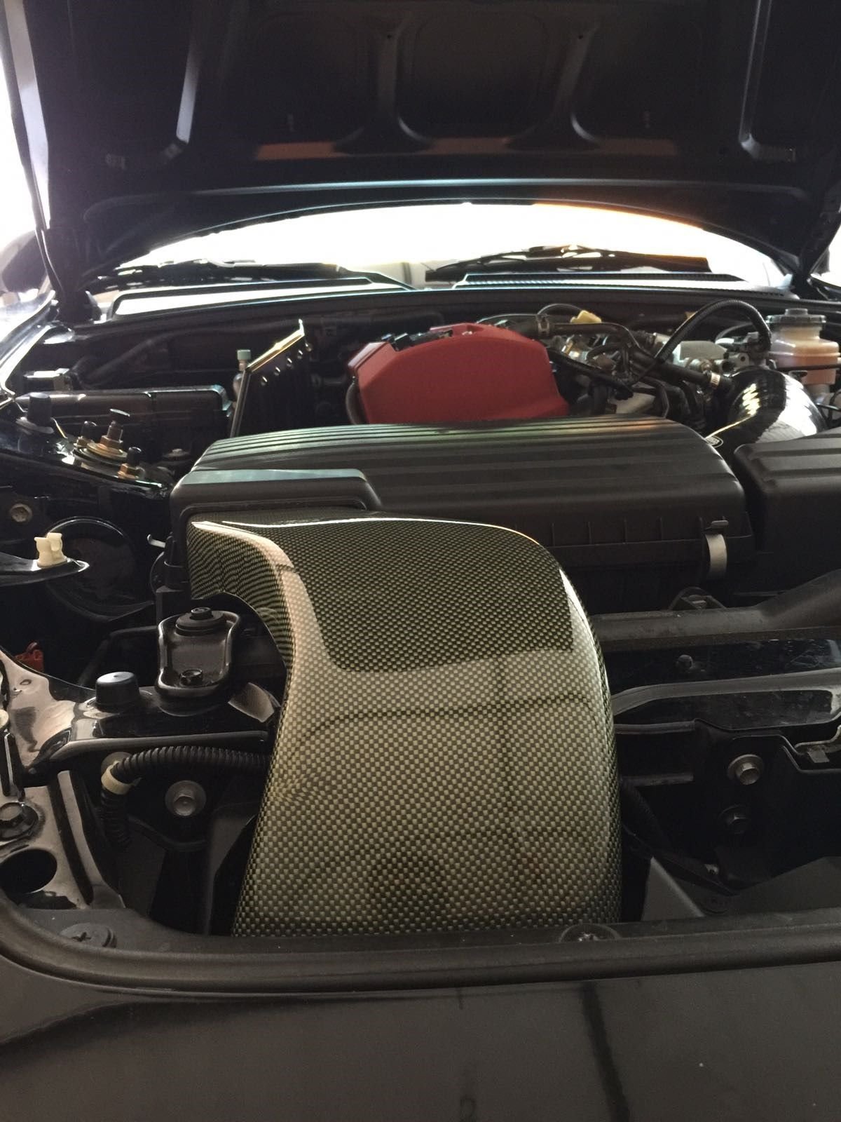

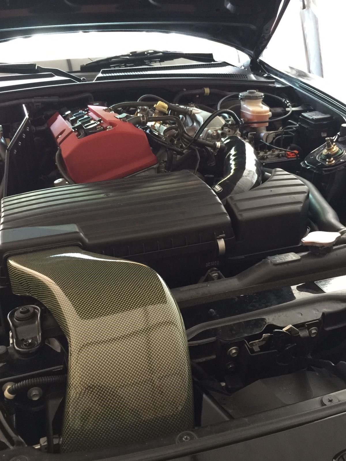

Syncmaster you are 100% correct. BUT you can make the stock intake draw cold air as well. I never see more than 5c above ambient with my stock airbox (drawing air from the fender area and with carbon cooling plate attaching to the stock inlet).

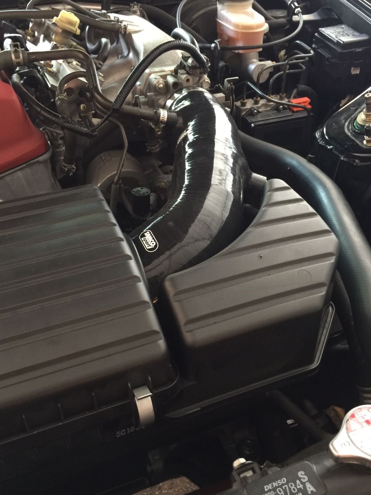

I love my modified air box. I am running a Spoon Snorkel, K&N Filter with the mid wall of the OEM box cut out and the resonator blocked off. I also replaced with the stock arm with a Samco hose. I absolutely love the setup. The car power wise feels excellent especially at speeds but the best part is the razor sharp throttle response.

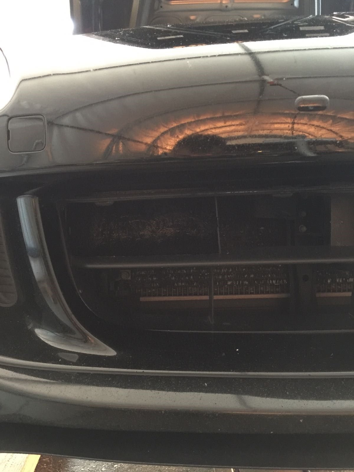

Adding a duct from that large opening in fender near passenger sideof stock airboxis an excellent mod. Cut 3" round hole in side of airbox, mount a 3" bulkhead duct flange, attach 3" hose routed into opening.
For greater effect, route that hose through inner fender area, add a 3" hole in plastic bulkhead that separates area behind grill from inner fender area, attach to scoop mounted in grill area. I think that is what photo of grill area in post above is all about.
You'll get fresh, cold air piped into stock airbox. It might actually be agood idea to block off stock rectangular intake at that point, to avoid flowing OUT one of the two possible intake paths...
