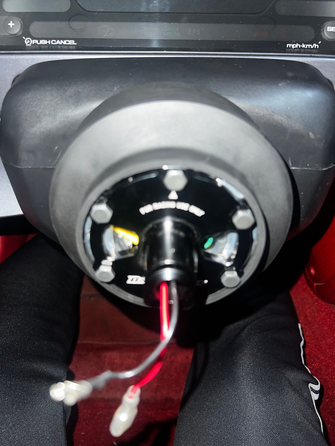

Since i didnt see a write up yet i decided to make one. My lazy behind finally got around to installing my battle craft quick release with my reknown steering wheel. I used the Works bell short hub for this install. BEFORE YOU EVEN ATTEMPT, DISCONNECT THE BATTERY.
Also you cannot fit the spirited cruise control adapter with this setup but may be able to get away with the steering solutions kit.
The work bell and battlecraft kit come with all the bolts and allens you need to install this. If you dont want to install the horn dont use the spacer provided by battle craft

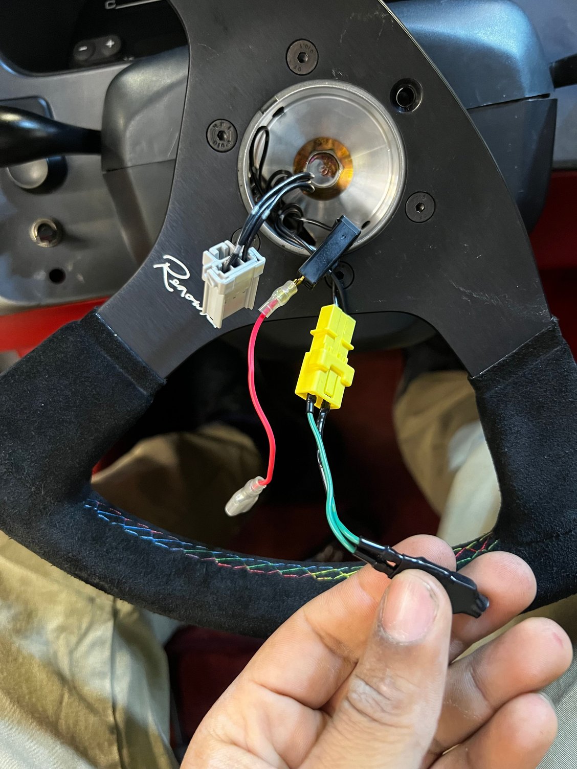

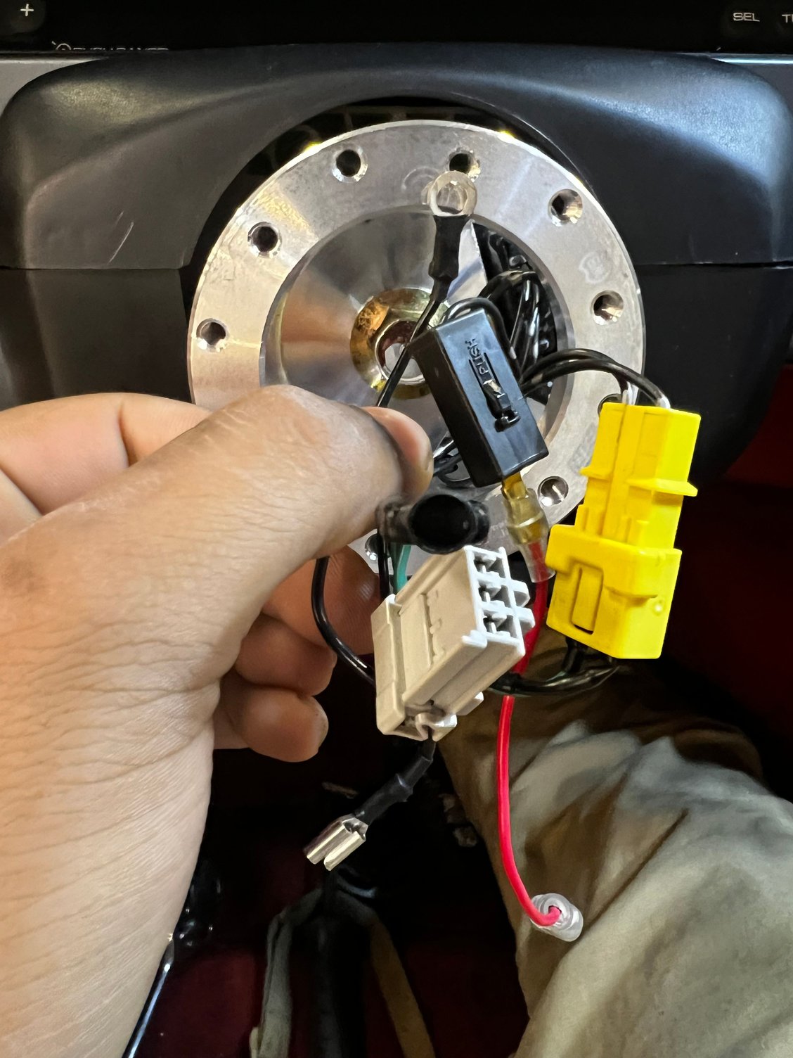

1.Make sure your steering wheel is either straight or locked for you to take the center bolt out. DISCONNECT THE BATTERY BEFORE YOU EVEN ATTEMPT TO REMOVE OR INSTALL THE STEERING WHEEL!For my case of using the works bell short hub i put the steering wheel on for more leverage and in case i had to take the hub off again. Works bell gives you the SRS resistor with the hub and from here is plug and play. Gray is cruise control, the black for the horn(Hot) and yellow is the SRS with the resistor in.
2.I wasn’t supplied a ground wire but i had a custom horn button made for me and it included a ground and a horn centering ring. For the ground wire i had to sandwich it in between the base and the quick release hub.
3. Grab your hub and feed the + - wires throughout the center. After that make sure you sandwich the ground wire and make sure the other wires are in the way when you tighten the bolts down.
4. Admire you got this far with no issues lol

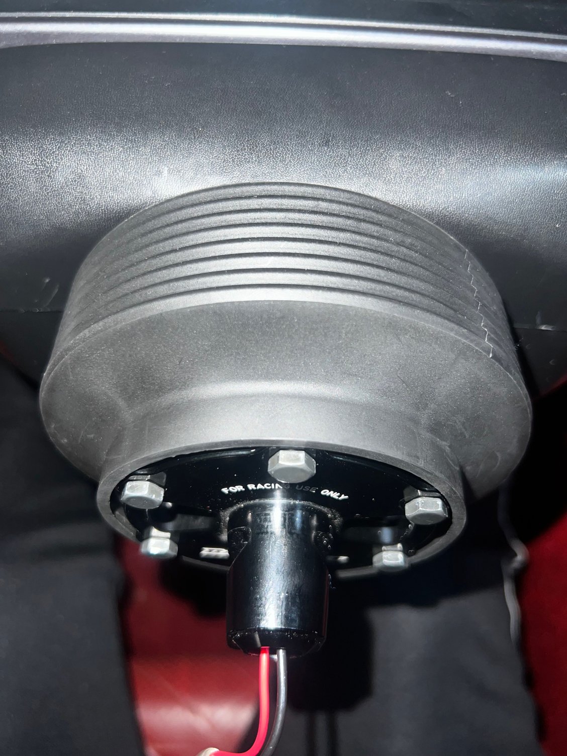

5.From here you can start assembling. Before i put on the quick release, I assembled the rest of the wheel, center ring and spacer. The spacer has provisions for momo,personal,sparco etc.

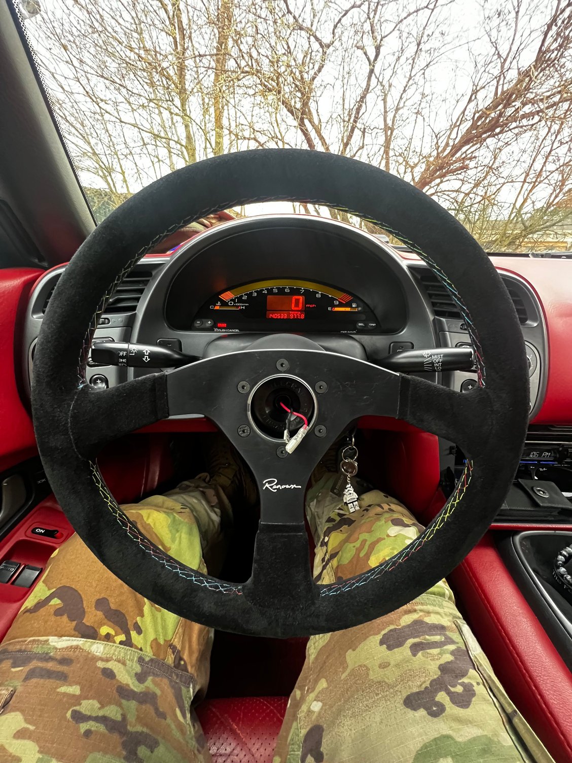

6.Make sure you feed your wires through before connecting the steering wheel to the hub. Once fed through you can connect the steering wheel to the hub.

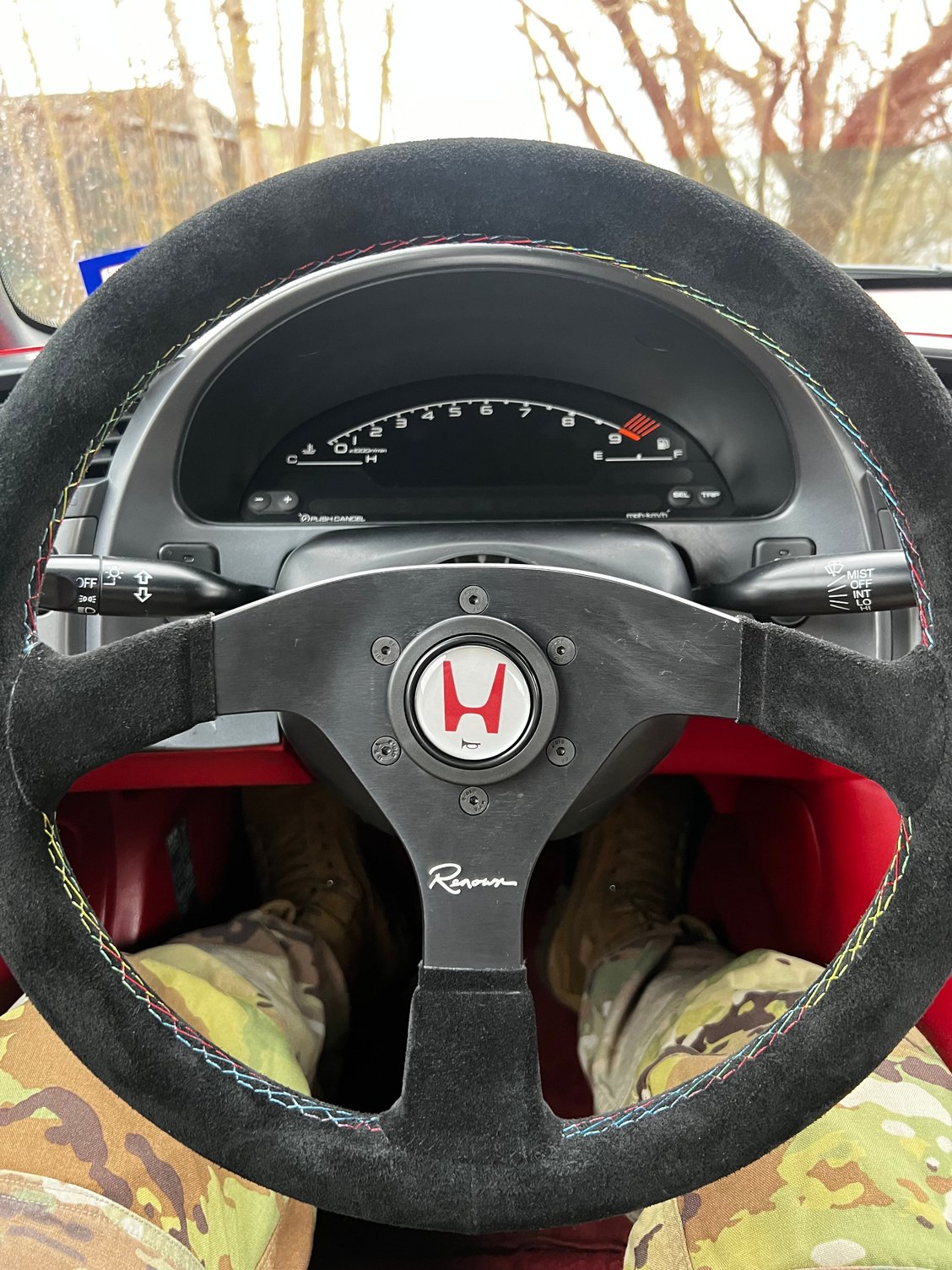

7.Supply your ground and power to the horn button then press in the plastic tabs on the horn to get it to seat into the center ring. Momo flush horn buttons WILL NOT FIT! Make sure all your bolts are tight then you can connect the battery to see if the horn and srs work.
Now the first problem i’ve encountered is that since the spacer is on for my horn, the turn signal and wiper stalkers are a tad bit harder to reach but not impossible. Also you may have the problem of the steering wheel either canted to the left or right even when the steering wheel is 100% straight. Dont worry, most likely need to get an alignment done to correct this. Other than that im happy how this has came out.
