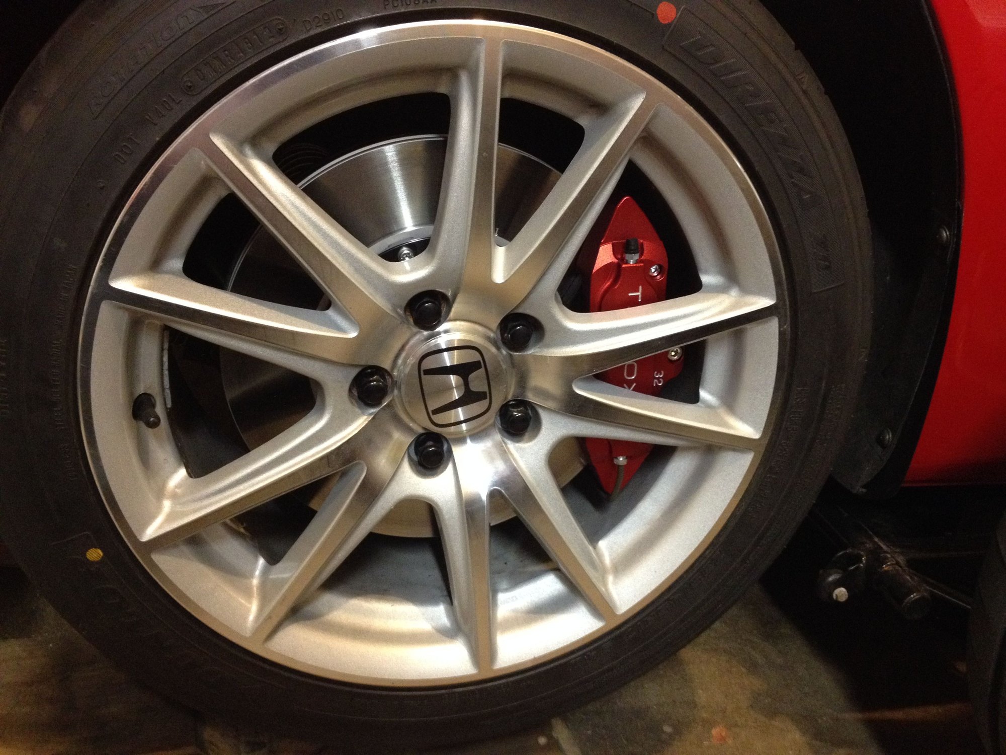

If you want to keep the OEM 17" wheels. I did.
Tarox B-32
