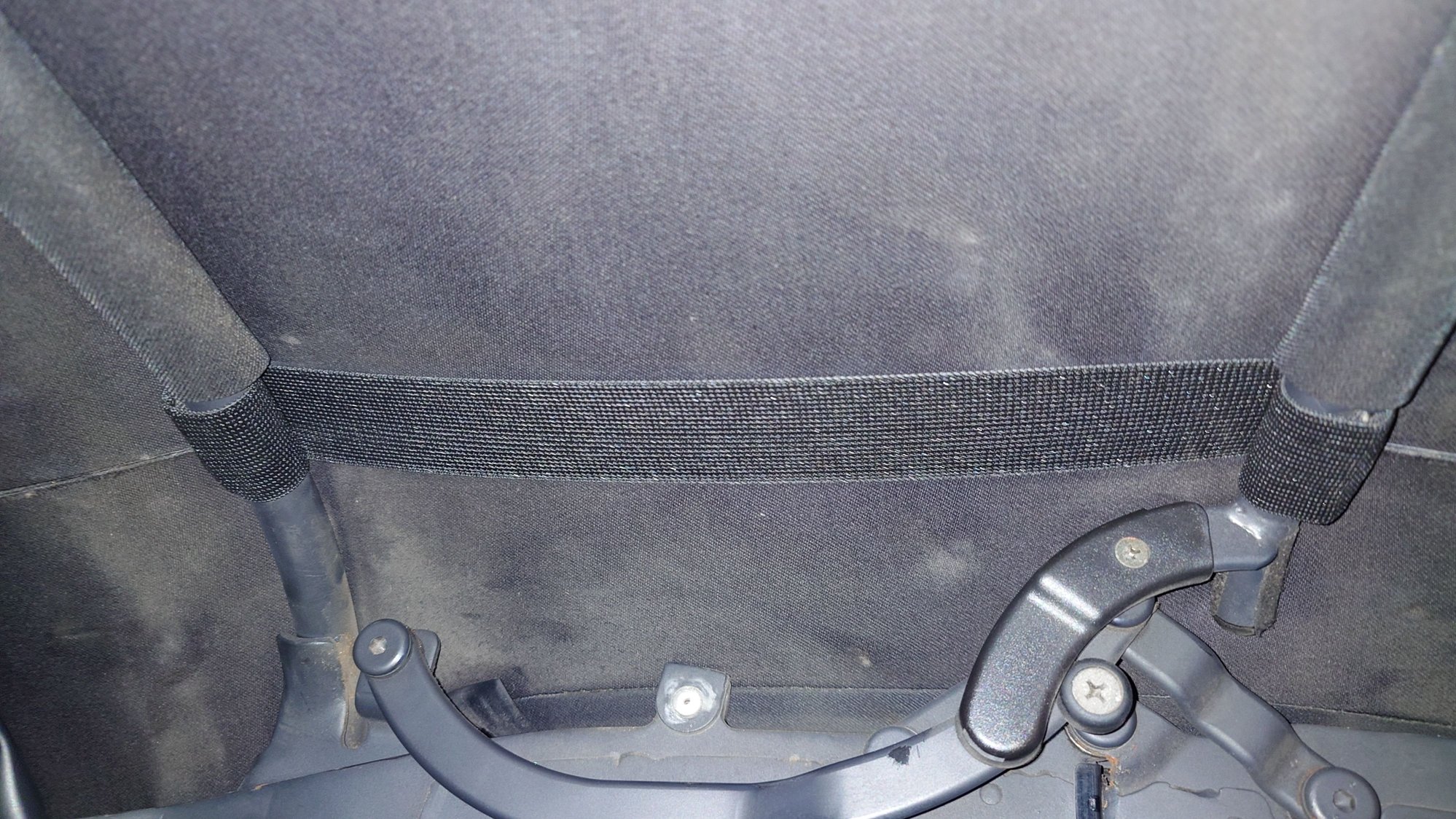

Thank you for posting these instructions. I just finished making the straps and replacing them and they seem great.
My old saggy strap
My old saggy strap
new installed
new installed
new installed
new installed
Glad it worked out. My straps are still going strong since I made mine so they hold up well.
