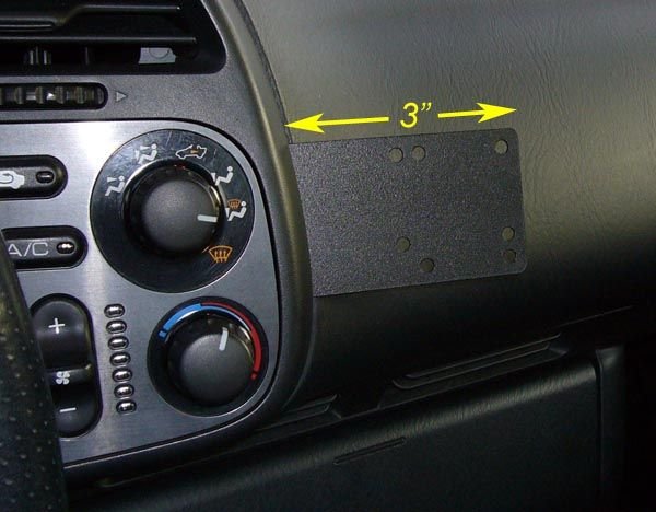

Totally getting this.
Which modifry bracket you getting? the 3 or 4 inch?

I've had the 4" for a while. I was trying to fab a dual gauge pod on it before I came across the DashDAQ, so I'll be using that. But I think the 3" would be enough seeing that the holes (not sure if it's the same place for the monitor) is on the far right side of the bracket and leaves plenty of room for the 4" screen. That, and the 4" bracket is back ordered
I'll let you know how it fits.

Looks like it should fit without any modifications...

FYI, the unit WILL NOT fit the modifry dash bracket. although the holes may line up, The OBD2 cable that plugs into the DD is in the back and would require cutting a hole in the bracket. Also, there's not enough room between the bracket and the dash to have the plug there. So far now I'm just using the suction cup thingy to mount it like a navi. It actually works well by the bottom driverside corner of the windshield. the cable is hidden in between the door and left side of dash and under to the OBD port. I'll get some pics soon...

EDIT 8/10/08: The unit may be used with the modifry 4" bracket as long as you're using the AEM/EMS port and not the OBD2 port <-- which doesn't have enough room behind the bracket for the connector on the driver side behind the bracket.
