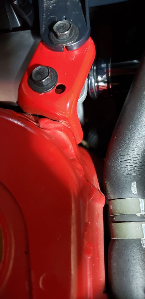

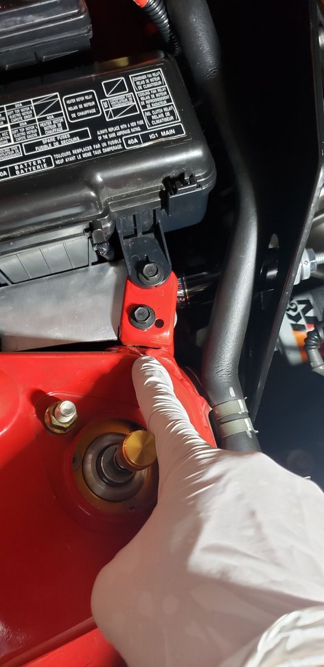

Anyone uses Puddymod mount have to reinforce weld on the stock fuse box mount? Mine is still intact (new engine mount) so I imagine the ETD is purely decorative now but as the engine mounts wear out, the engine will move a bit and that stock fuse box bracket is not going to cut it....only a couple small spot welds is keeping it in place right now it looks like.

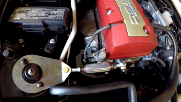

If we can somehow source (or make) a bracket like this (gold color in pic) itd be perfect.

That’s the j’s engine torque damper and strut tower bar. Pretty sure it’s still available.

Yeah but you have to buy the whole strut bar and ETD etc...to the tune of $450..
Also the bar will rub the intake tube.

Ahhh I see. Maybe try hitting up LHT performance? They make the master cylinder brace that mounts in a similar way I would bet they could make that bracket pretty easily.

Ingalls ETD is what you need - too bad it's discontinued - much more secure and effective mounting compared with other ETD
I'm using the Megan/Hardrace engine mount with Ingalls ETD.
