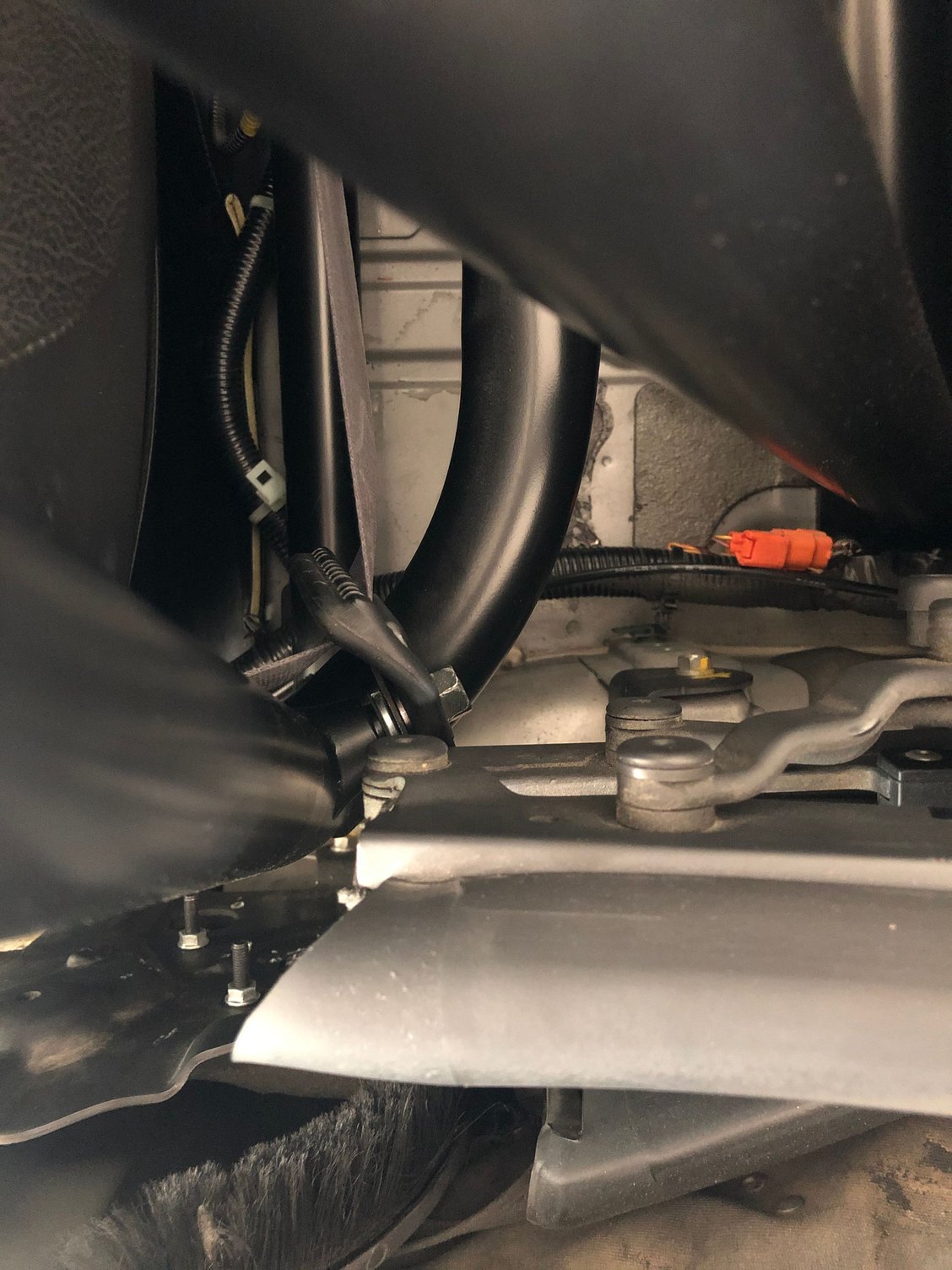

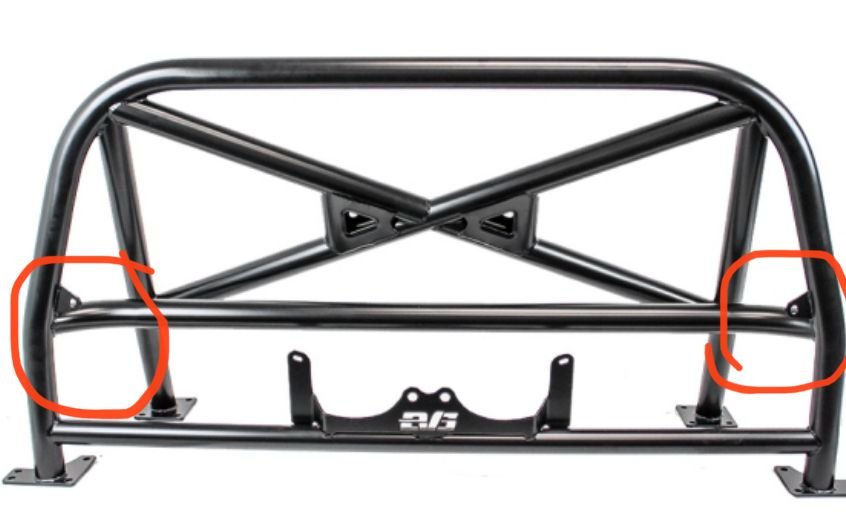

Default EVS Tuning Roll Bar Install Issues
5) Spare tire doesn’t fit anymore
I wish EVS gave disclaimers to their products. I understand this is a “race bar” but these are things consumers should know before taking the jump in spending the money on a roll bar

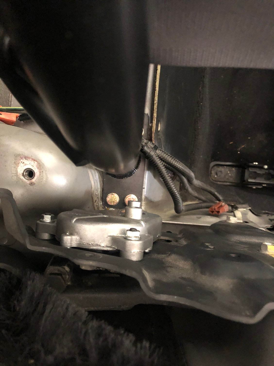

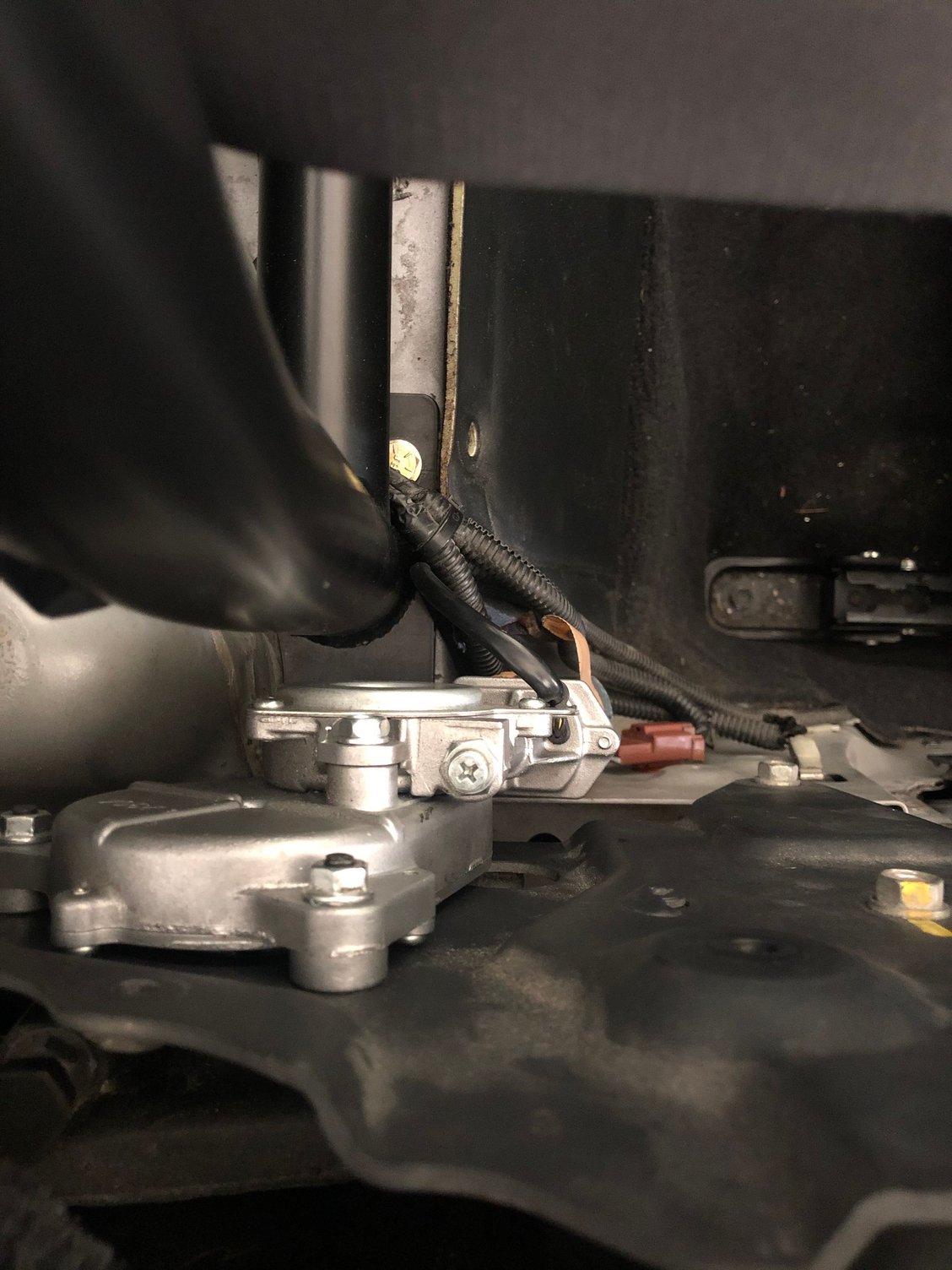

I was able to keep my soft top motors in with the EVS Roll bar. After removing them to drill the holes that I had marked, I installed the soft top motors back in. Then angled the roll, with the help of another person, to slide the front of the roll bar behind the soft top motors. Hope that makes sense.

Nice! I actually gave it another shot with fresh eyes. I was able to seperate the softtop motor 2 10mm bolts and then placed them in there.
