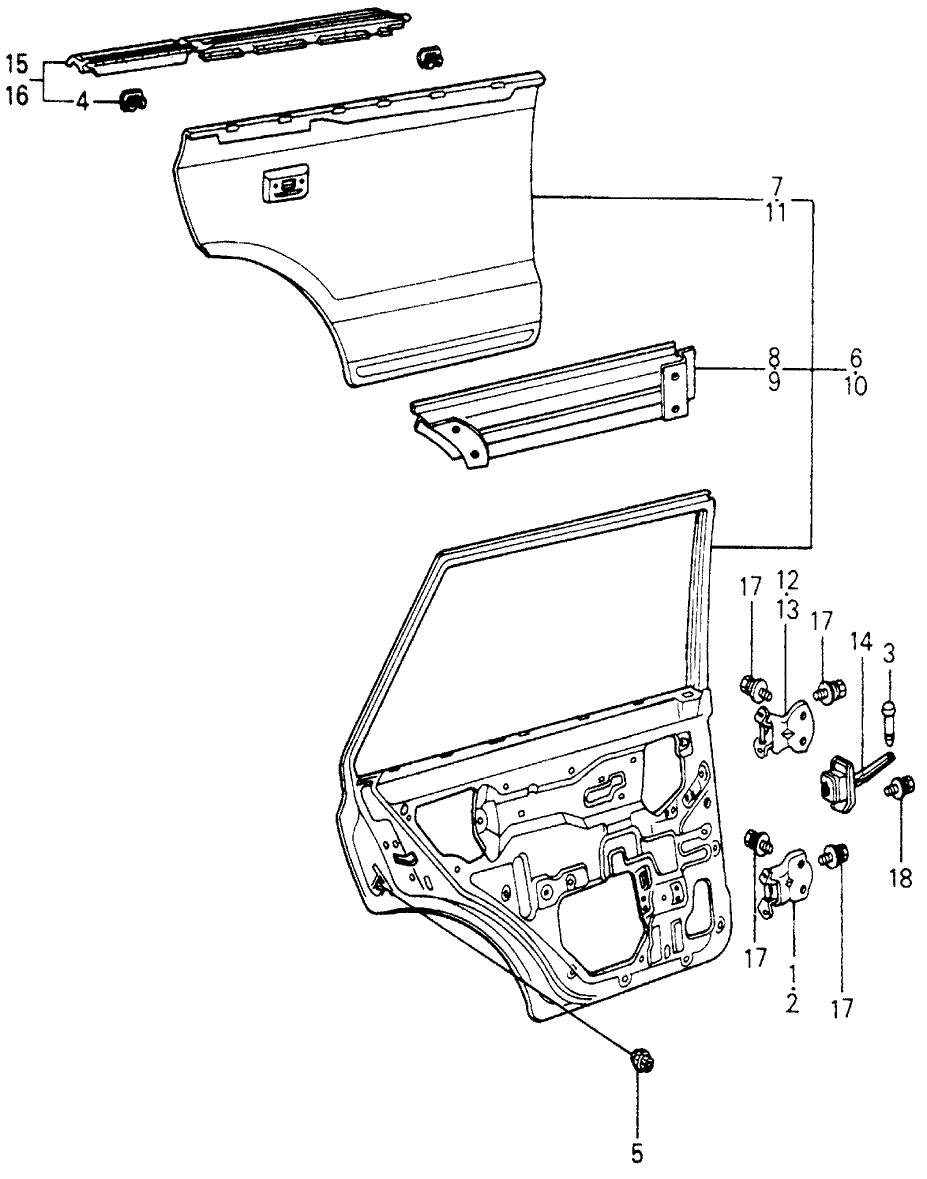

I am currently swapping soft tops on my s2k (swapping entire frame, so its all out of the car right now). When I was removing the rain rail, a piece of rubber that looks to be bonded to the black plastic molding (74866-S2A-033) started to tear and now needs to be replaced. Is this piece of rubber part of the molding? In order to fix this properly, do I need to remove that molding and buy a new one online?
Any help would be appreciated. Thanks!

Post a picture, I did a search for that part number but nothing came up.

It is part 16 in this picture.

Can you post a picture of the actual tear? There are 2 pieces of rubber at the very end of that piece that are stuck to the frame with adhesive, plus the rubber/foam gasket that is glued to the bottom of that piece that meets the top of the trunk. I'm guessing you're referring to the section of that piece that sits inside the well area.

Yes, I will get a picture up here as soon as i get home. From your description, I believe it is the second piece you mentioned that runs along the length of the trim. My guess is it seals the gap between the rain rail and the body.
If you take a look at my extremely shitty MS paint drawing, the red line is kind of what the tear looks like. The red line represents the bit of rubber that is hanging off the trim. The tear happened as I was pulling the rain rail off the studs on the body.

Ok, let's wait for the picture. I didn't need to pull this piece off, but one of the rubber pieces at the tips of this piece did tear off when I pulled the rain rail off, and I reattached it with double sided trim tape. I also would consider high quality silicone, weldwood contact cement, or shoegoo, but please post a pic first before pursuing recommendations., that's an area that you don't want to fail before the next top replacement...

Awesome. That appears to be the exact part that is torn. On a related note, do you have any tips on how to get the trim out? Those guys say it is easy, but after removing the bolts it's being stubborn in my car, and I have read it is very delicate. Does it just require patience and even pressure? It appears as though you have to slide it towards the front of the car to get it off the sheet metal; I will make sure I'm not forcing it in the wrong direction.
