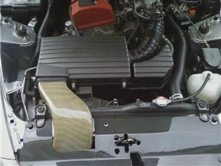

it pretty much just slides in you do need to cut the plastic piece in front of the radiator and lose the trumpet on the airbox lid here is a pic of mine installed

mm im interested in one of these. you someone link me to something similar to this?
is it this? http://cgi.ebay.com/ebaymotors/Honda-S2000...Q2em118Q2el1247
Old Jan 12, 2008 | 06:38 PM
LcS2000's Avatar
Joined: Apr 2007
Posts: 669
From: loveland ohio
yeah thats the same one i bought in the pic above great quality imo
