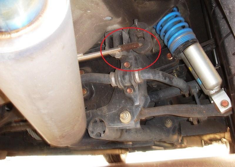

3. the fitment of the 60RS is better than most exhaust ... some people with the earlier release put a piece of rubber tubing over the hanger to keep it from tapping the frame (under extreme WOT situations...) but most haven't found this necessary. And this happens with other exhaust too.
FWI - the rubber goes were the arrow is at the hanger.. (NOT at the circle were the cross member is)
2. the 60RS is not loud (single is supposedly quieter than the dual). The drone at 3k - 4k is there, but minimal... and the WOT sound is music
better shot....
you just need (if you hear it vibrating) a 2" piece of tubing... (maybe 3/8" id - I honestly don't remember)
most hardware stores will give it to you as a "sample"
just slip it over the hanger and you're done.
