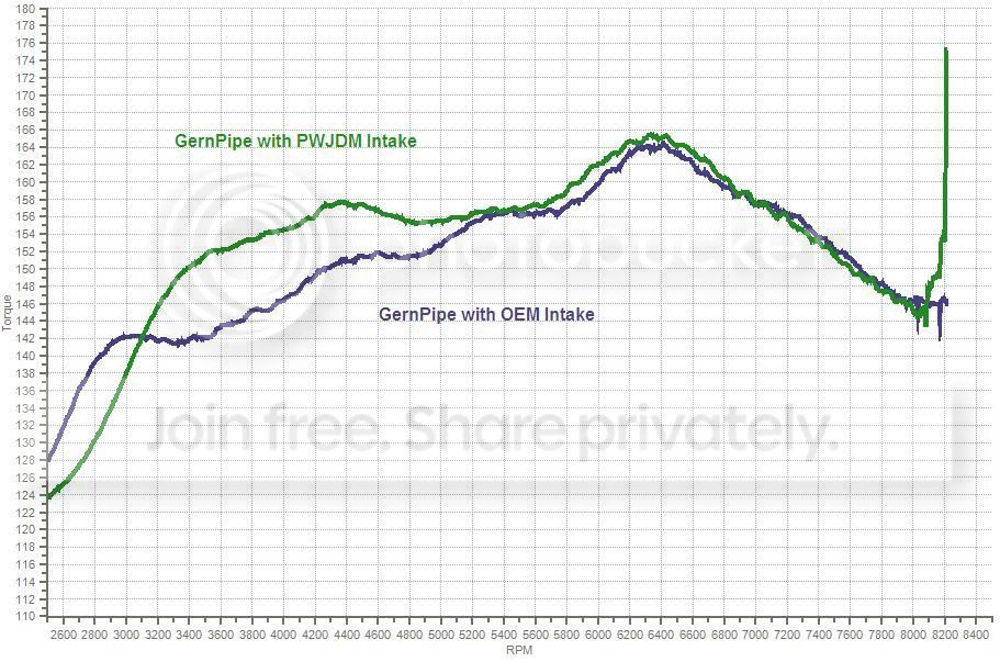

Since I'm getting close to a final design for a single muffler option, I decided to put my OEM intake back on in order to repeat my tests. Even though the OEM Intake doesn't make as much torque as the PWJDM, I really just think the torque curve of the GernPipe and PWJDM combined is less enjoyable than what I get with the OEM intake. Basically, the PWJDM was a great combination with a conventional exhaust, since it gave a nice boost in torque in the range where the conventional exhaust was robbing torque. However, since my midpipe doesn't rob power in that range, I would much rather have an intake that provides gains higher in the RPM range.
Here are the torque plots from a controlled test I did last night.

I'm really just not a fan of the FIPK, since it sounds so bad with a low VTEC engagement. That opinion has nothing to do with my midpipe. Even with a test pipe, which allows a ~3600 RPM VTEC engagement, the FIPK sounds bad.
However, the torque curve of the FIPK combined with my mid-pipe was great. It doesn't have the issue that my PWJDM has (too much low end torque).
