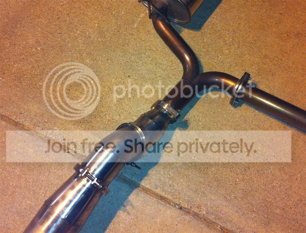

The adapter pipe for the Greddy SE dual turned out really nice!
