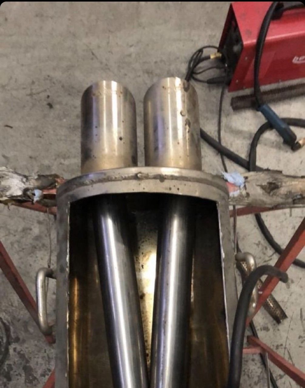

I am looking for modifying my muffler like this, cut and weld these two parts together wich basically looks like the UK mod just inside the Muffler.
did anyone do this and can give me some feedback or suggestions for improvement or any different idea to improve the sound but make it look stock?

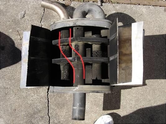

I think it would be LOUD the way you are describing, as it would literally be a straight pipe if you just connected those. As I understand it, the UK mod puts in a parallel path with a smaller tube so that some of the exhaust is diverted but some still flows through the muffler . So you would want a smaller diameter pipe to connect between those two pipes closer to the point of where they exit the main enclosure to better simulate the UK mod.
Closer to my poorly marked up image below (The green part). Have not seen it done that way so cannot tell you how it comes out, but based upon what I have seen of the UK mod this seems as close as you can get and keep it on the inside

... And it's going to cost a LOT more to do it internally. Not to mention how ugly the muffler is likely to look after that open heart surgery. Muffler shops aren't known for making clean welds.
You'd instead want to take the exhaust to someone with a tig welding setup, not the mig welder most exhaust shops would use. Not sure how much of that applies to whatever country you're in.
The shop is going to have to strip the whole muffler skin so they can reach the underside of pipe they would weld.
So which will look worse, a small uk mod pipe you can't really see even when you're under the car working on it (unless you get in the exact right spot, and look straight up behind the muffler), or a pair of mufflers with ugly weld seems running around the entire front and rear circumference, a large part of which will be visible just bending down behind tbe car?

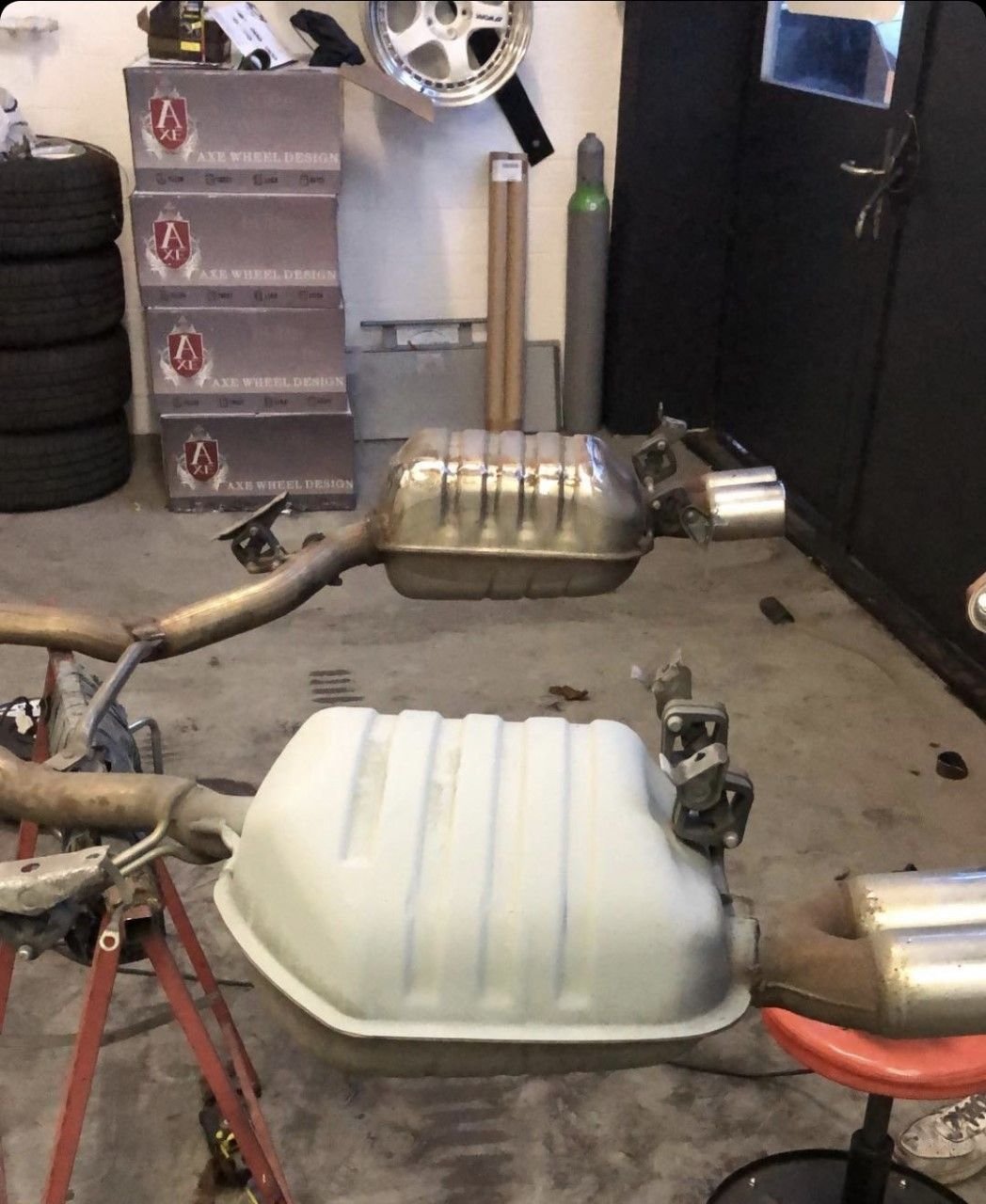

first of all, it is really as bad here in switzerland as it sounds with the cops. I had the invidia q300 wich was one of the best sounds ive ever heard on the s2k and I had street legal papers for switzerland BUT after a DB noise measurement it showd that my car is louder than it may be. (for understanding, every Car haves a different registret max. DB Noise that it may have.) so the legal papers where for SH.T ! so i got fined with converted 2000$... no joke.
so thats why the muffler shops are like doctors here in switzerland. see the pictures below... you cant see sh.t.

the finish product (the under one), after a few weeks it will look like a normal old, and used muffler
open heart surgery
more open heart surgery

I think then going with my pictured approach may be your best bet. It "should" be like the UK mod which from what I hear is not much louder. Your straight through approach will be louder than that Hard to say what it will blow for sound. I run mine sometimes for big autox events with the muffler section pulled (turndown just behind the drivers compartment and it is pretty loud. Not as bad as you would think (94dBm passing the sound meters at WOT at events) but very obvious there is no muffler . Your straight through mod may be quieter since it uses more pipe and splits through two mufflers, but would still be pretty close to that I think.
