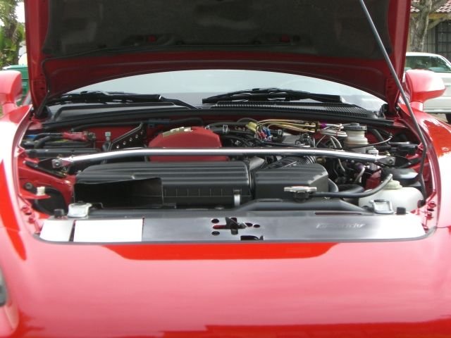

I'm currently running a 75 shot direct port, but will be bumping it to 125 shot very soon via AEM EMS. At the 75 shot the stock ECU is doing everything and the car runs great. The best thing you can buy is the window switch, it allows you to program the nitrous when to kick in and when to shut off.
