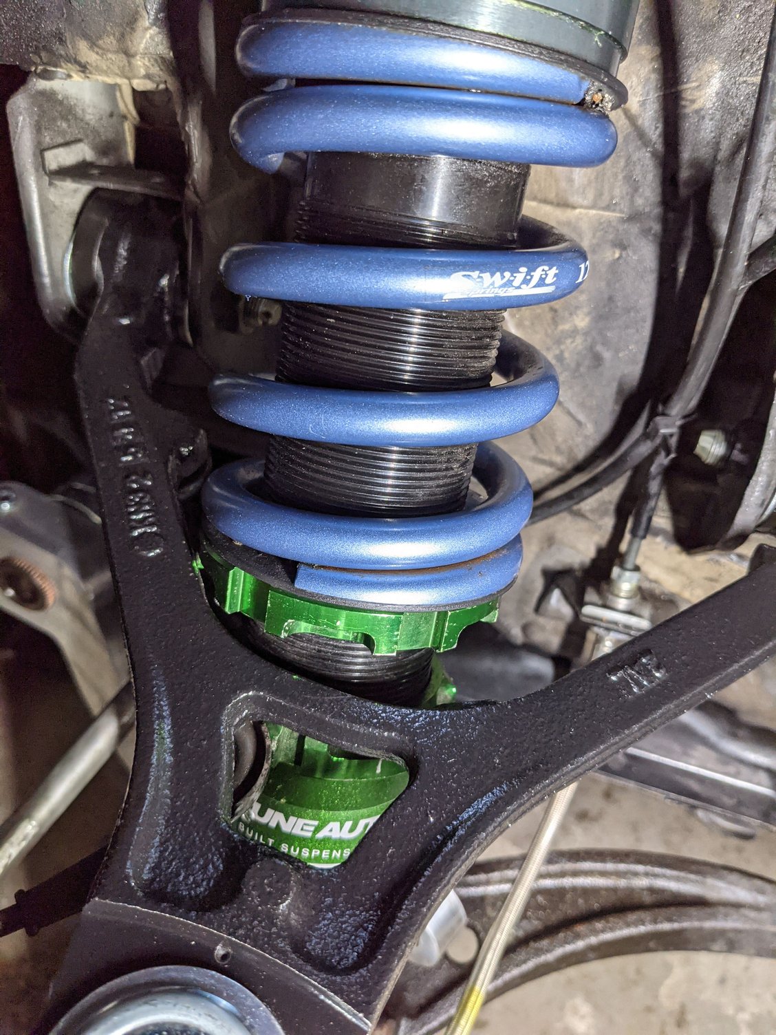

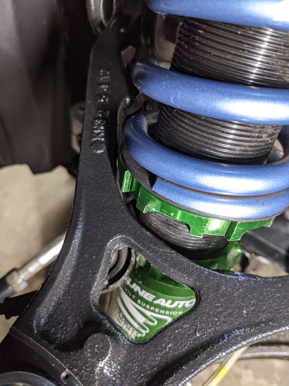

I have the bushings and the fortune auto air lift coilovers. I don't think there is enough room to move the upper control arm inwards 7mm. The arm is already so close to the strut that I think it will hit. It might just barely fit but I don't want to go though the whole pressing out bushings part to find out. Has anyone else installed these bushings along with this suspension? I think with most coilovers the spring collar sits higher cause there isn't an air cup taking up space. If the spring was shorter I don't think I'd be worried.

I bought a used upper arm, installed the bushings on that and test fit it. I think it just barely fits. I drove around a little bit on it and didn't hear any noises. The car still lifts just as high so the arm isn't hitting the collar. The part that is closest to hitting that I can see is the lower locking collar for the bottom cup that attaches to the lower control arm. I'm gonna go ahead and order the left control arm and fit both of them and find out if they really work.

I've got them installed and the car had been aligned. I haven't noticed any noises from the front end indicating at contact between the arm or spring perch. I've put a few miles on them and have hit a good amount of bumps here in Massachusetts.
