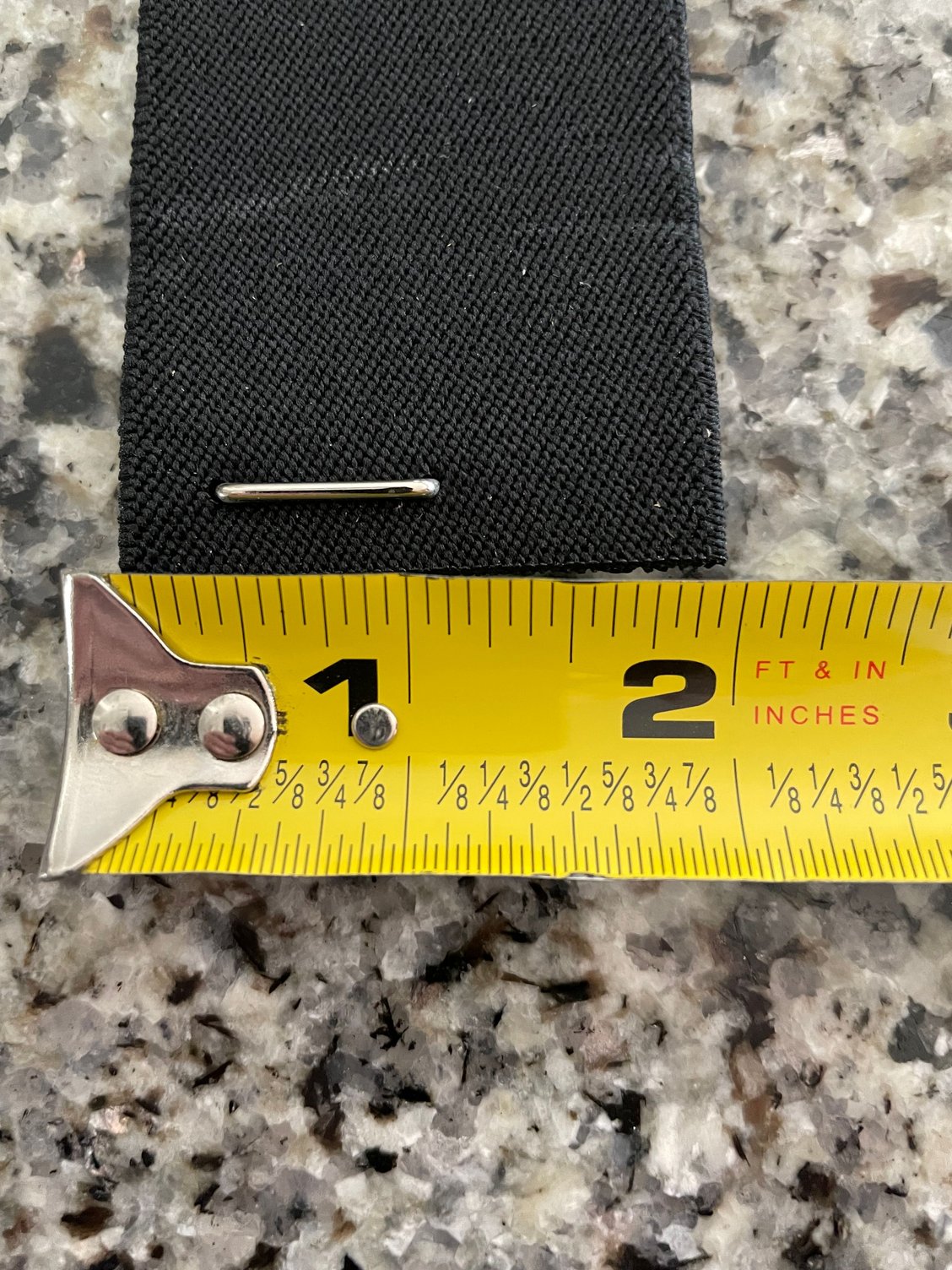

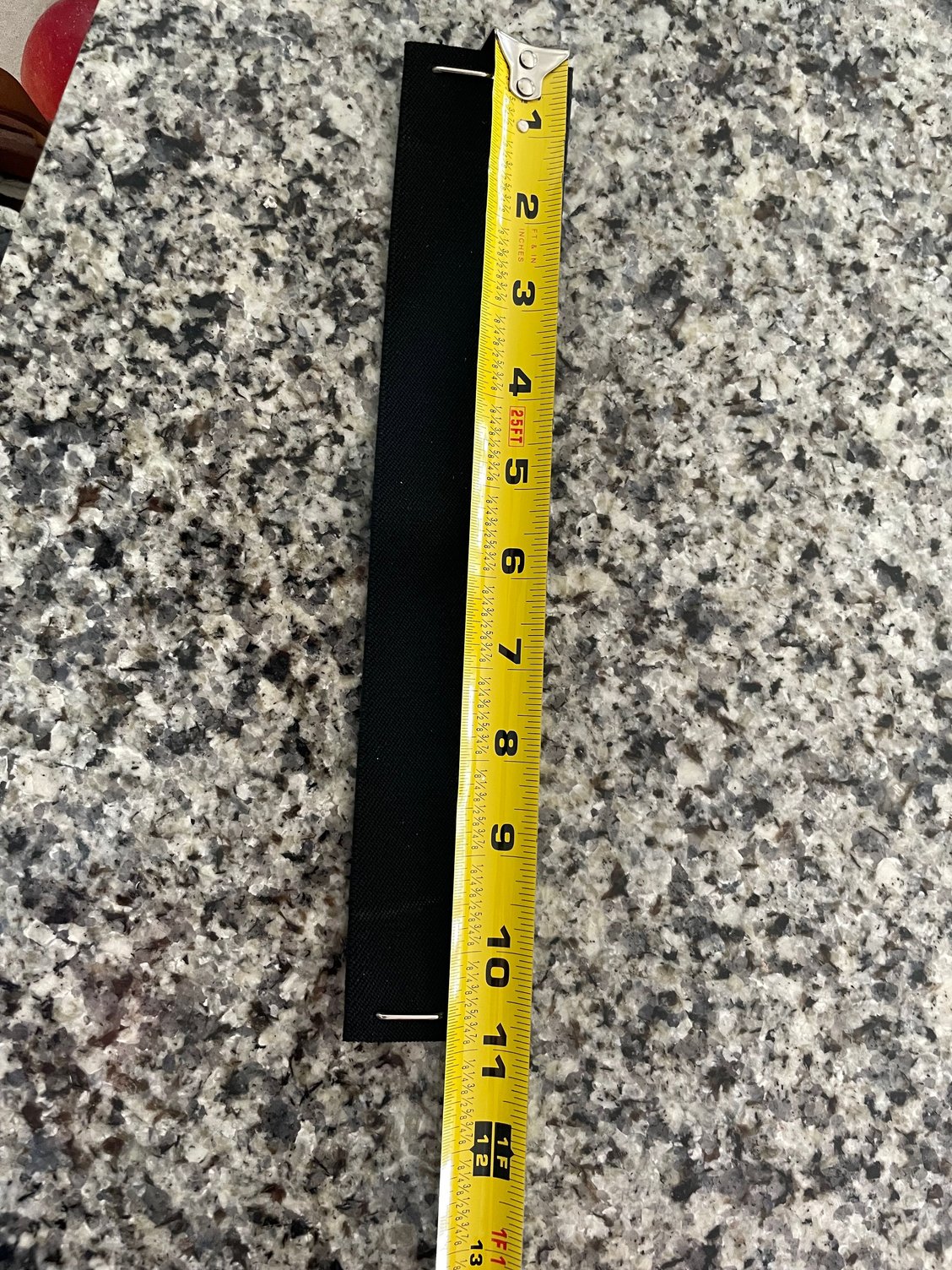

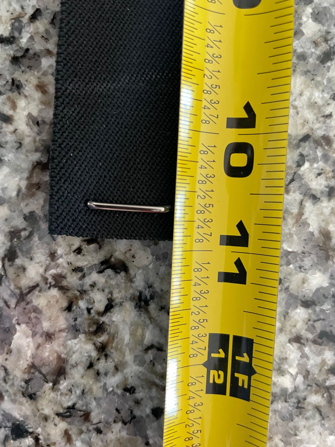

The straps are not generic judging from their construction and the instructions. They're specifically designed to NOT remove the rivets in the cross bars using pins on specific spacing to go into the rivet holes. Here's the data I just copied and measured from a still in the envelope set of repair straps.
Someone feel fee to combine this into something we can retain here.
-- Chuck

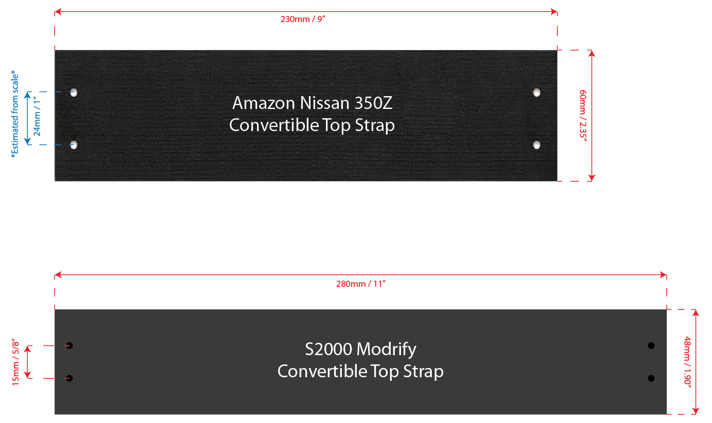

Thank you Chuck! Those measurements are what I was looking for!
I don't believe the 350z straps will work now looking at the measurements. It appears the eye-to-eye size of the staple is larger on the 350z. As well, the 350Z strap is shorter by about 2".
Here's a scale drawing of the measurements...

Note the S2000 pins (staples) are not centered in the strap, apparently the close and far ends are important as to if they go toward the center or edge of the bar. The Modifry strap is significantly longer as it has to wrap around both bars as it's not riveted in and the over-wrap holds the pins in the holes.
There may be some parallax in the photos so millimeter tolerances are probably not needed. I put a set of these in my roof frame when the car was 8 years old in 2014 because the originals were as loose as noodles and hanging down with no evidence of elasticity. Installed a new Robbins cloth roof in June 2019, the new Robbins straps are riveted in just like the OEM were, and there is a good bit elastic tension on them right now with the roof up. Don't recall how the Modifry straps were after those 5 years when they were removed.
Gotta be a dozen folks here with these straps on their roof bars who can expand this information.
I mainly posted this as I doubted these were generic and a random strap from another convertible would do. Let me know if dragging these straps out again can answer more questions for you.
We're hoping someone picks up on these as there seems to be a market for them.
