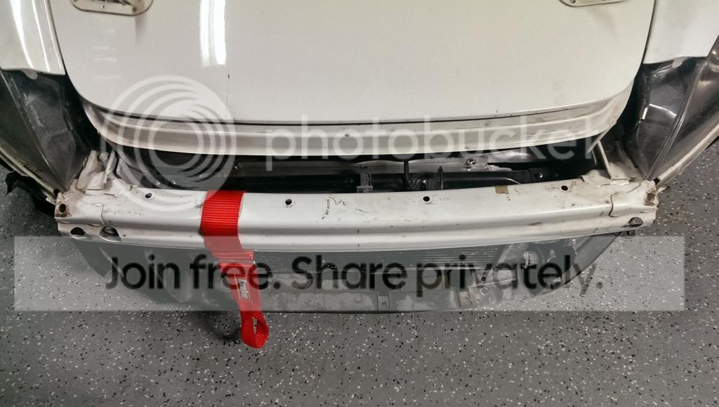

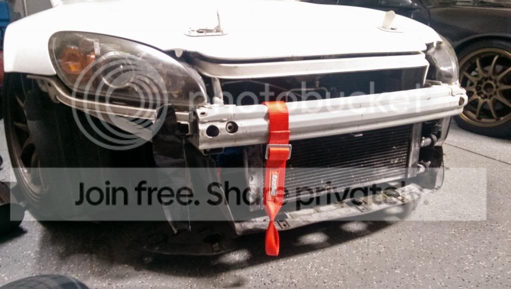

Good timing. I just installed my strap. It's a RaceQuip unit
http://www.racequip.com/towhookloopstrap.html

Good news, the front bumper beam already has holes.

In theory you mount it directly to the chassis (or a support member) and pull it straight out without wrapping around anything. Premise of-course that everything can support the load including the mounting hardware.

Imagine the strap riding up if the tow vehicle is higher and it pulling and bending or cracking the bumper. I don't like the strap at all unless it can pivot at a certain place

Agreed. I haven't put the bumper on yet, but will be playing with the strap position and adjusting so that it won't rotate and essentially pull the bumper cover off the vehicle.
