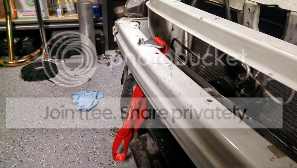

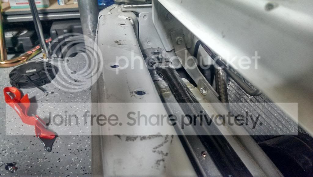

It'll be pulled in reverse not forward, is the way I see it. Since it's wrapping around the bumper, there will also be a twisting moment as you're towing. I think it'll work fine and is how I plan to reconfigure mine (I just played with mine and couldn't get the buckle to stay put without it rotating around). I would drill a new hole more towards the front of the beam so that they'll be more meat when its being pulled in reverse.
Old Apr 18, 2014 | 06:23 AM
99SH's Avatar
Joined: Nov 2005
Posts: 2,677
Likes: 9

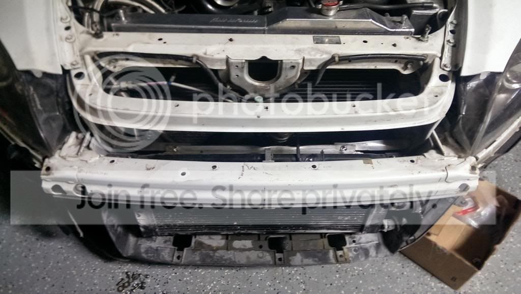

Drilled a hole a little more forward:

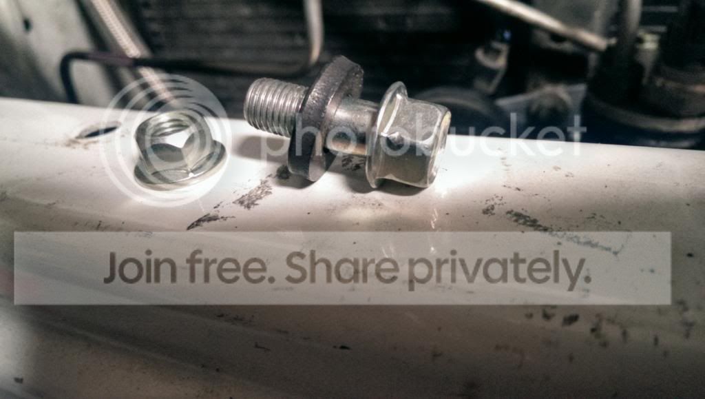

Found some grade 10 hardware in my bin
Looks to have enough support behind the hole
Mounted
