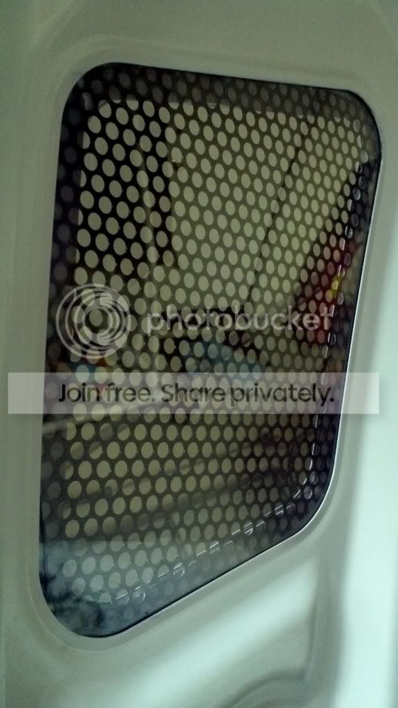

1. Aluminum Mesh, Fly Screen (Soft Aluminum in your case), Screening Spline, Spray Paint, Duct Tape, Scissors, Sheet Cutters
2. Trace out the vent and cut it leaving about 3/4 inch margin. Paint it.
3. Cut you fly screen/aluminum to size, and tape the edges together with duct tape.
4. Slide it in between the hood.
5. Seal it with the screening spline.

YES! Thank you so much for the pictures also, I can use this as a guide
