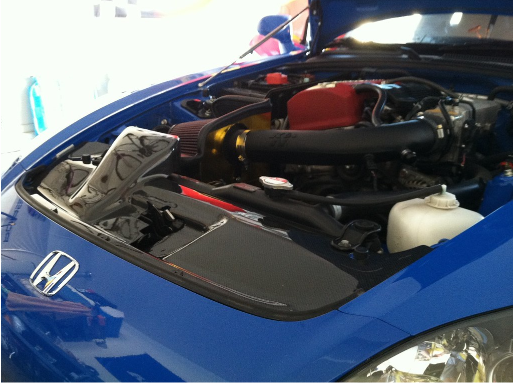

.Whilst I was originally a massive proponent for keeping the OE airbox with some slight modifications to aid overall cooling and airflow, since reading through all these threads I'm now of the opinion that the investment may not be justified. In particular, the only snorkels I can now find are genuine J's/Spoon ones for several hundred dollars, and the same goes for cooling plates. Additionally, if you were to make all the above modifications it doesn't actually leave much of the OE components in place anyway other than the shell of the box, defeating the point somewhat of embracing Honda's engineering.
This moved my attention briefly to the K&N FIPK system which is another popular choice and maintains a relative short ram system with the filter in the engine bay.
K&N FIPK
This was one of the primary aftermarket intakes that caught my attention, not least for its relative simplicity, OE fitment, noise and cost. Upon initial reading, it appeared to be a good option to mate with an AUT cooling plate for added cold air flow as well as wrapping the outside of the heatshield and/or the intake arm in DEI reflective heat wrap to minimise heat soak.
The factors that ended up putting me off this option were it's relatively cheap looks (subjective perhaps) and the fact it was still susceptible to heat soak despite being "sealed" when the bonnet is shut. I don't subscribe to that school of thought given it is clearly not a fully sealed unit and air will always follow the path of least resistance to get where it wants.
The deciding factor however was the intake arm and it's small ID, something that has been raised many times (particularly in the CAI threads I'll link to in the next section). It seemed to me that this wasn't a particularly well optimised system that justified replacing the OE airbox, unless of course you were most interested in more induction noise. Whilst the scale of these issues may not be fully quantified, I didn't like the idea of my filter getting more hot air than the OE box and drawing air through a smaller intake arm than even the factory one.

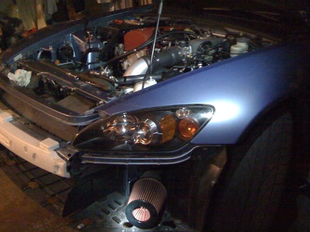

CAIs
When I originlly read about CAIs I dismissed them fairly quickly for two reasons. First and foremost because I just felt they looked too DIY and difficult to make look OE (again just my opinion). This is something I still have to reckon with vs the OE airbox. Second, I had reservations around the common filter location in the inner wheel liner getting the filter excessively dirty from being so close to the road, affecting overall flow over time. It also seems like a difficult/incovenient place to access and inspect the filter condition on a regular basis.
Many people also raise valid concerns around an increased risk of hydrolocking, but I would agree with the general consensus that applying common sense and avoiding massive puddles will avoid any real issues. Interestingly, a few users note that in fact the bigger risk comes from leaving the car exposed to rain which can allow water to pool in the piping, depending upon how it is angled. For me this is also not of concern given that the car is garaged overnight and used almost exclusively for track, largely negating both risks. That just leaves the need to inspect the condition of the filter on a regular basis for excessive dirt build up vs having it located in a more convenient location within the engine bay that is also less susceptible to heavy soiling (though an argument could be made for snorkels creating a similar "issue" which has also been noted in a couple of posts).
These reservations aside, I read a lot of feedback from users both on here and Honda Tech that the high revving Honda VTEC engines benefit from a long intake pipe that creates optimal resonance with the obvious side benefit of drawing cold air into the intake from outside of the engine bay. User b.r.i.a.n seems to have a lot of experience in this field alongside tuning these engines, with further testing done by Gernby over the years, though I can't personally account for them.
When reviewing CAI setups a lot of useful testing and comparisons have been made between both different length pipes and different internal diameters including some pertinent findings with regards to incremental step changes before the TB to maximise velocity. The risk with the very custom/DIY nature of these setups is not accounting for the optimal design characteristics that lead to increased efficiencies vs. slapping something together that leads to losses rather than gains.
In short, feedback and testing would suggest that there is such a thing as too long an intake pipe which will take you beyond the point of diminishing returns; much like can be said for too short as well. The most up-to-date information I could find implies that running a pipe down to the fender well nearest the TB is better than routing the piping all the way along the opposite side of the car. Equally important is the ID and step changes of this piping, which research suggests is probably best configured with 3.5" piping from the filter up until 6" before the TB, at which point it is recommended to step down 0.5" to a 6" long straight section of 3" pipe to maximise air velocity and ensure smooth air flow into the intake.
Pictures help explain more clearly. Filter location:
3.5" to 3" straight section before TB (ignore pipe routing):
