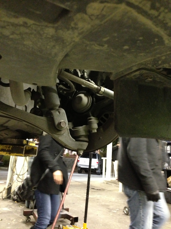

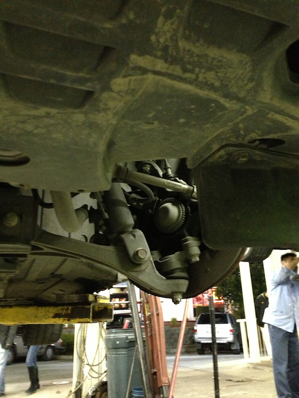

New front rotors and pads for me tonight, and look what I found:
Tiny little brake cooling channels in the front under tray. For the future I am planning on extending the curved section down with an addition piece, to at least go as low as the front wheel diffuser, and see how far it can extend towards the wheel hub without rubbing anything. That with a nice guide mounted to the front control arm to help focus the air at the center of the rotor. Could be a really nice and clean brake cooling solution.
Seriously could be as simple as buying 2 more front wheel diffusers, and screwing them right into the under tray, bending them to follow the curve.
