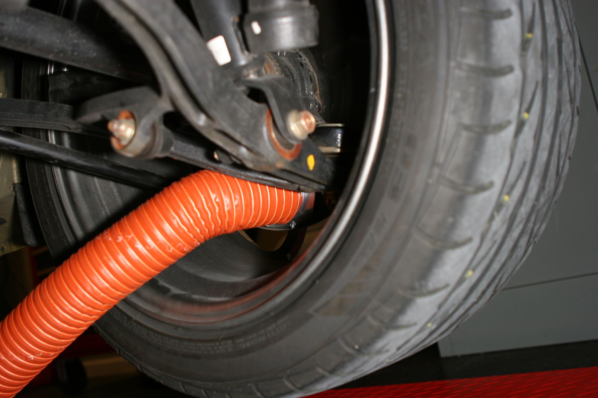

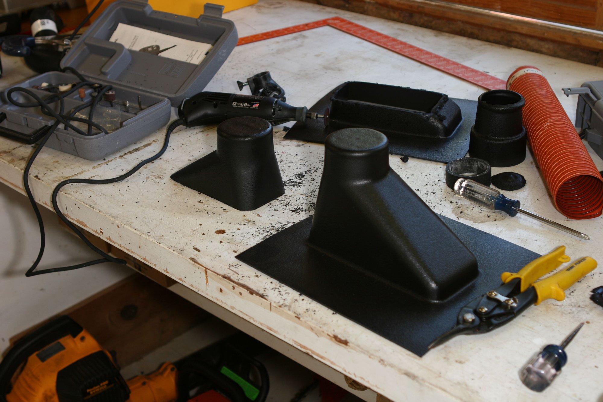

Here are some pics of my front and rear ducts. We also installed 2.5" ducting using the faux inlets recently and worked it around an AEM CAI. The front ducting shown here is 3". I found all the info needed here on S2KI. They make a big difference on track days.
Front ducting.
Rear ducting.

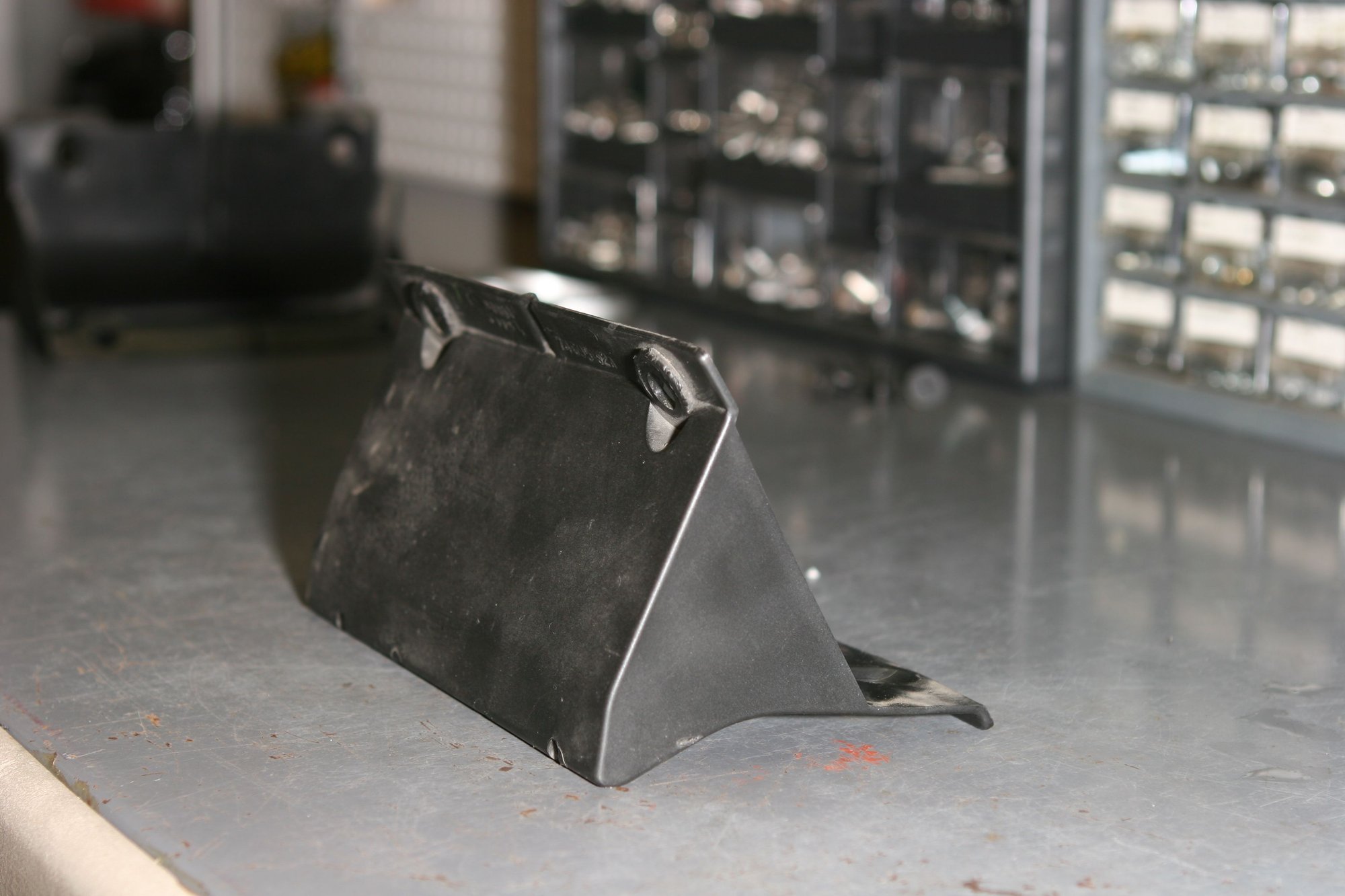

Remove this air deflector and install the rear scoops with washers and OEM bolts.
