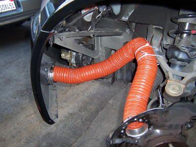

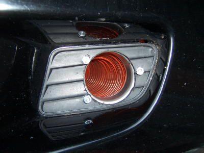

I just added vents thru the faux ducts using 2.5" ducting. I'd stick a couple pix in, but something's wrong and I can't get to my albums. Just took the car to Thunderhill yesterday and I was very curious how well they would work. It was a warm one (103 deg) so a good day for a test. Bottom line, after a 30-minute session, ending with a cool-down lap, the rear rotors were at ~ 450 deg, and the fronts were at ~ 250 deg. I didn't do a before and after, but I know the fronts used to run hotter than the rears. So they definitely work. Now, maybe I need to vent the rears.
Only glitch, I didn't have full clearance. If I turned fully, I got rubbing. On the track it's not an issue, but in the paddock I had to keep reminding myself not to turn too sharp. Looking back at other pix, I see I didn't route the ducts exactly as shown, but it's close.
For reference, I'm running 17 x 235 RA-1's on the standard CE28N Volks rims (17x7.5 +50).
I'll follow up with the photos soon.
Old Jul 28, 2005 | 10:10 PM
  #22
depletedUfoot's Avatar
Posts: 203
From: los altos, calif
Here are the photos. (Turns out my membership had expired.)
You can see the rub point in the second photo. Need to get it down and under the upper arm, I guess.

From: Covington WA, USA
With stock wheels, tire size, and suspension, it is possible to route 3" ducting so that it doesn't rub. 2.5" should be easier. YMMV if your car is not stock.
Yes, exactly. It needs to be under the upper arm, not next to it.

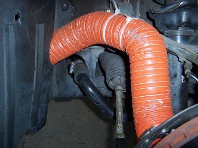

Yeah, mine were in the same place before I figured out they rub. However, if you push them even more toward the back so the cutout can only be a half circly, you can squish the line enough so it doesn't rub but allows enough air flow. I saw an install like this that worked ok.

I just re-routed mine a little and added a third zip tie to keep the vent below the upper A-arm and the A-arm bracket (visible in the very top center of this picture). Added some duct tape to protect the rubbing point, just in case this doesn't completely fix it.
Stuart
