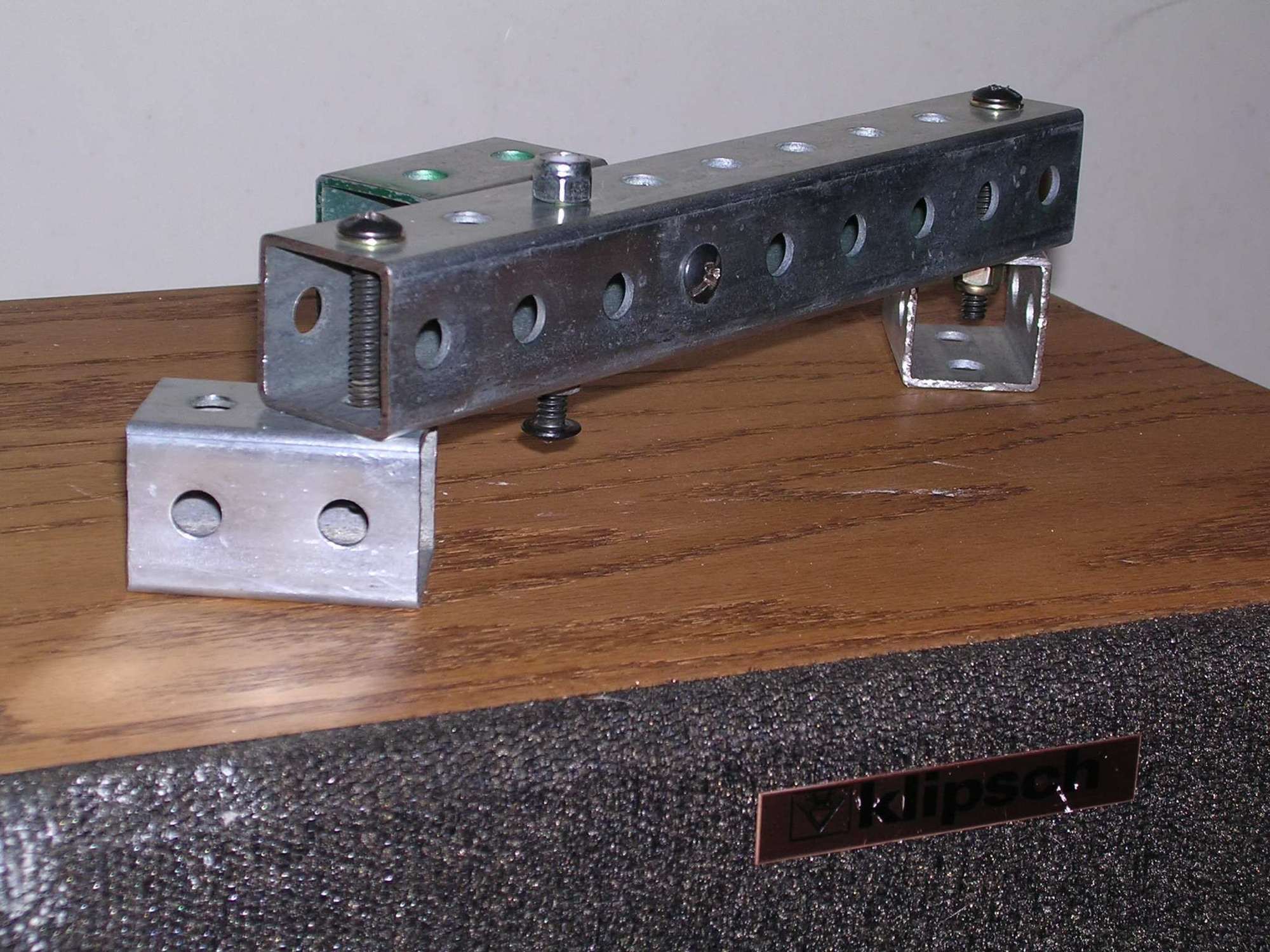

I went to Lowe's and bought a piece of channel for $12. I had the rest of the hardware sitting around the garage. There is nothing special about the threads for the universal camera mount-- I happened to have a bolt that fits it perfectly.
The mount fits in the windscreen holes using the same screws as the windscreen. Takes 5 minutes to perform the swap, if that.
It may not look great, but it works well and was cheap. I guess the one real drawback is that I need a wrench to tighten the camera down. If I weren't lazy, I would find a wing nut at the hardware store to take care of that.

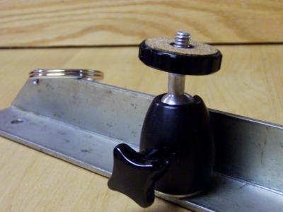

I made my own bracket (see photo) and bought an adjustable attachment from a camera store for about $28. The rings are to attach a strap to minimize camera vibration. Also, I found that a wide-angle lens really helped the view from that location.
The microphone inside the car is a great idea, because you get a lot of wind noise otherwise.
Sometimes the best ideas are the simplest. I love the angle iron idea. Onky 2 questions:
1 Where do you attach the strap once you put it through the rings and do you have a picture of that?
2 How well does that adjustable camera attachement hold up? Does it loosen up and allow the camera to move off of the shot you set?
Warren

The strap just goes over the top of the camera. Snug it down and it eliminates most of the vibration. (I don't know if the more-expensive mounts are steady as built, but I have to restrain the camera a bit.) I'll take a picture of it tomorrow and post it. I'm also trying to post a 2-minute video from Cal Speedway I took using it, to demonstrate the results. Can't get it to upload so far, however.

Instead of the straps, I would suggest a tripod head. B&H sells just the video heads, without the tripods. Check them out on this page - http://www.bhphotovideo.com/bnh/controller...arch&Q=&ci=3951

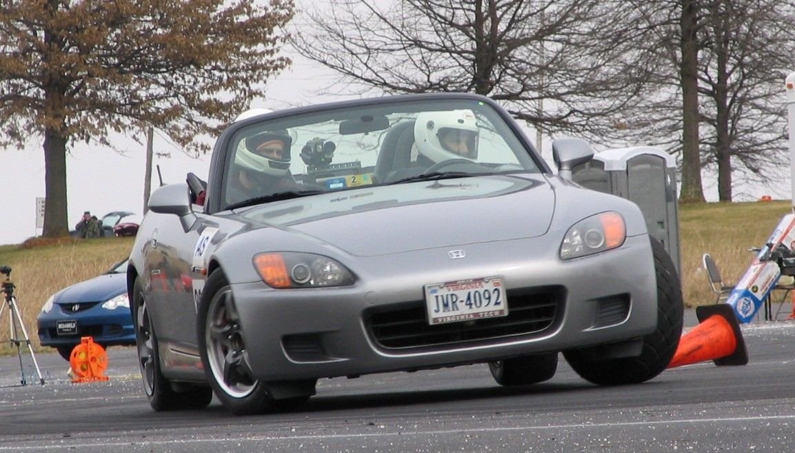

Here is my setup in the car. The strap is probably overkill, but it works.
And no, the mount doesn't loosen or move during the day. It's quite stable.

Here's a short video I took at Cal Speedway with my set-up (about 3 posts back). Check the field of view and the stability. There is a lot of wind noise, but my camera won't take a remote mic. I think I'll try putting some foam rubber over the camera's mic next time.
http://www.gofastvideo.com/gallery/item/pr...onda-s2000.html
