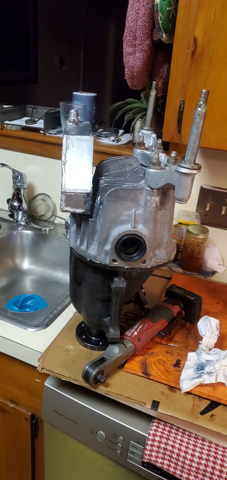

I used a marine self prime fuel pump with a 19 row cooler along with a 2.5 qt capacity sump I fabricated myself. I can make most anything if I have time and resources... car has novi1200 with a vmount setup and a 30 row oil cooler for the engine all oils only get 210-220f. I've not done anything to the trans. My flatbottom starts at the transmission it feeds into a diffuser. Before I built the sump cooler setup I was seeing Temps go into the 250+f range to the point you have to stop driving it hard. I have a Tomei lsd with apr bolts on the caps and a js racing pinion collar. I have a puddymod stage4 but it's back for a checkup so this is the spare. I'll be making another sump with a broken diff I have. Well I'll be using the aluminum back as I pushed the threads out of the driver side main cap . If anyone wants a sump I can do it will need the type of exhaust with pics using a machine ruler for exact clearance.mine is close.the sump can be made smaller as well. I will say having a sump is the best way to run a cooler as it let's you get a good prime on the oil pickup. Stock capsity is on the small size. I run the cooler with the lines up so it always has a prime on the system. I use a mocal temp sensor/trigger to run the pump when it sees 190f and Jiffy-tite Series Quick-Connect fittings to add my oil and with the cooler full the whole system is about 3.5 qts . Had a buddy over the other day when I was Changing my oil jet bolts and he said I'm driving an imsa endurance racecar on the street.. By they where all bad/ spring failures and on an f22c with the 4 hole units had low idle pressure 15 psi now I have 35psi and 100psi above 3k rpm. Anyway if you have any questions let me know.
