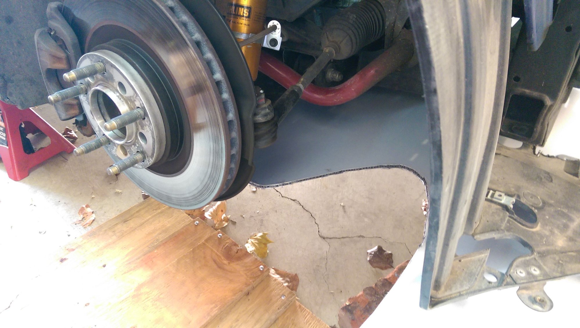

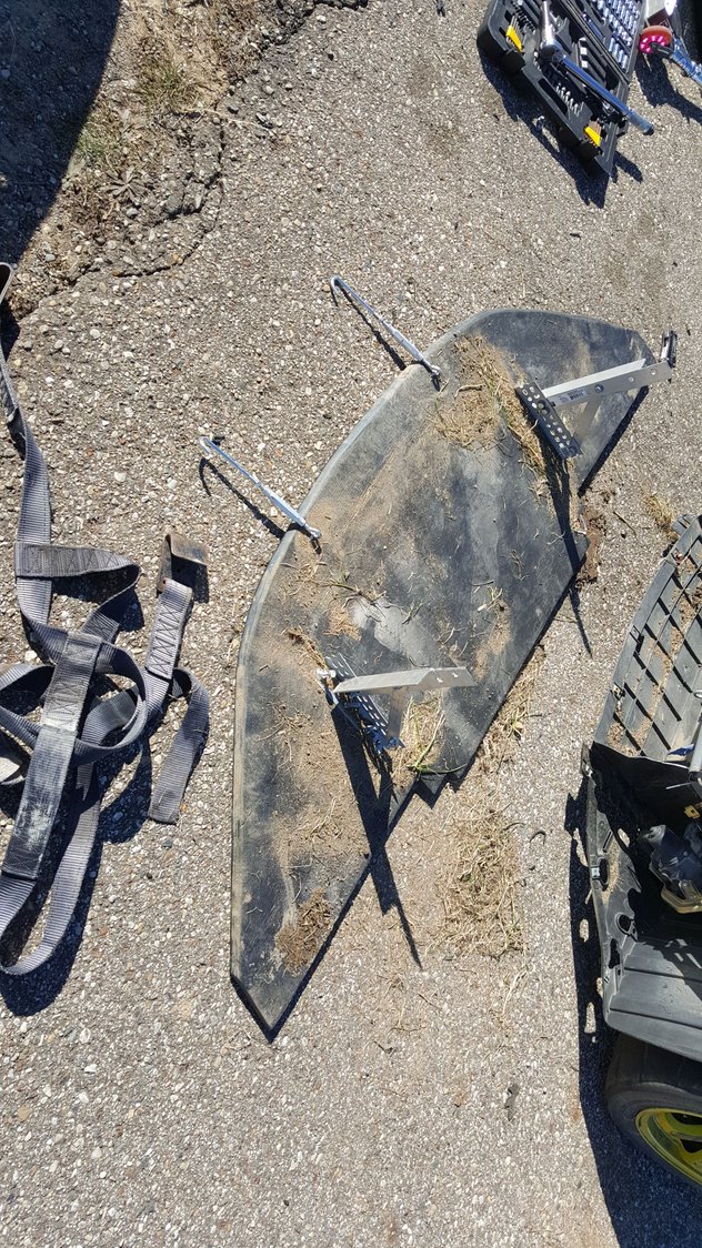

I should also mention i run a diy plywood splitter aswell
A minor off cracked the supports. I can stand on the splitter, but a frontal hit it will break/tear the aluminum before it bends my frame rails
