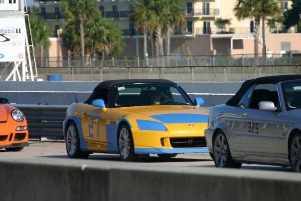

Took my '06 out to Sebring this weekend, first time I've ever had her out (though I've done several other events in other cars). Bone stock execept for some Hawk HP Plus pads on all 4 wheels.
2 days, ~4 tanks of gas, 2-4 rotors (depending on what the rears really end up looking like), a full set of front brake pads, half a set of rear brake pads, a set of front tires, some boiled brake fluid (yes the high temp variety - TYP 200), and two front calipers that probably need to be rebuilt (need to talk to Honda about that one...) later...
I might have been a little rought on her but totally worth it to make the 911s and Caymans really have to work it to stay in front of me - and to leave those that didn't well behind me.
She will now sit in the garage and wait for me to have the time and cash to replace what needs replacing.
As an aside, if you have any experiance on the track, don't use Hawk HP Plus pads, spend the extra 50 bucks and get some carbotechs or something.
