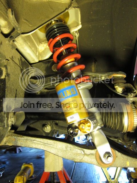

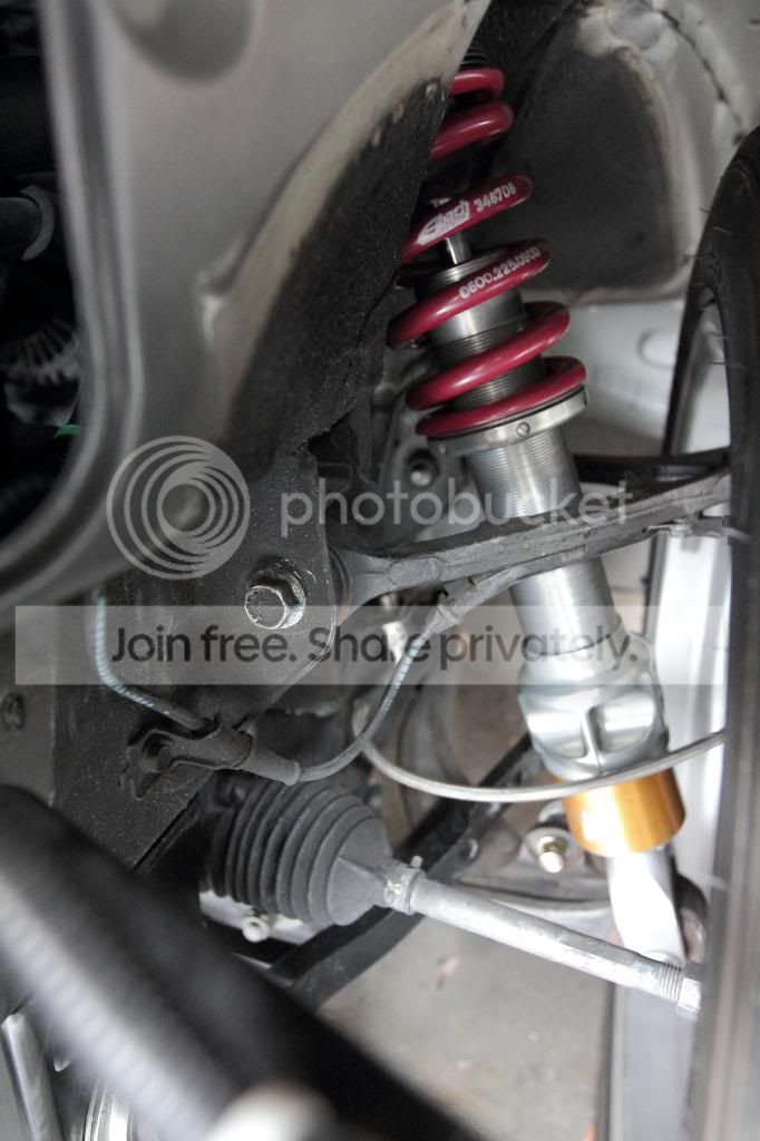

Originally Posted by mLeach
If you went with 2.25 springs would you have a little more room to suck in the rear, or is something else limiting you? In the front, I imagine it rubs when turning at full lock....
I ask because I'm interested in SP/M but want to keep the car as narrow as possible.
The tire will hit the frame (outside of square shaped top shock mount) before the wheel hits the spring. The wheel will hit the the control arm (2nd pic, on the oval shaped marking) close to the frame mount at moderate-full suspension droop and a sharp steering angle.
