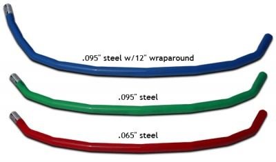

Just for reference, late model stock cars, which do a fair amount of pushing, use a bent 1.75" x .095" or .065" wall bar. They are cheapest to buy pre-bent to fit the nose, but builder with fancy tube bending equipment just make their own. They sell bent for $30. I'm guessing ti would be pretty simple to fab a mount for the tube to the S2k.

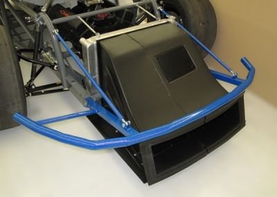

This is a mounted bumper, a little fancy with that bolted top link, in a pic to show the flexible radiator ducting. As I said, the push each other around a bit.
