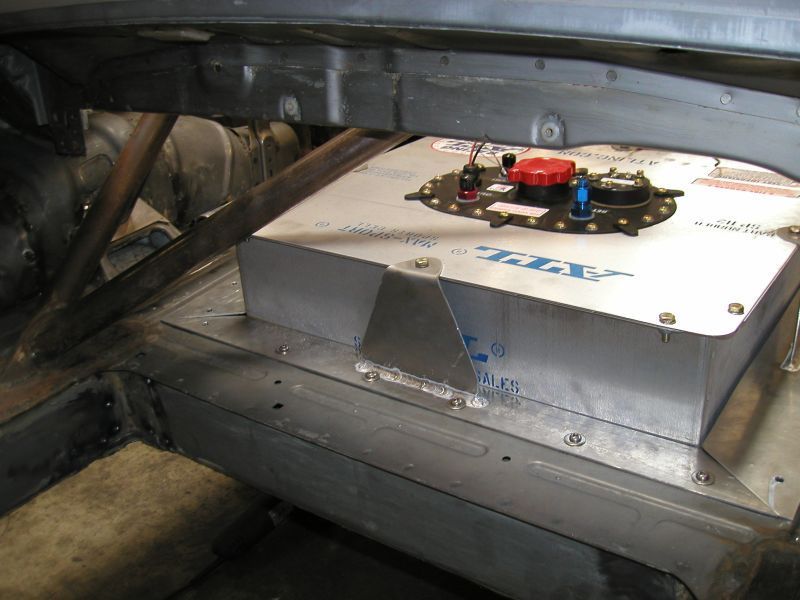

Specs: 12 gallon capacity in stock midship location
internal hi pressure pump,
internal trapdoor scavenge, can run down to as little as 0.6 gallons
probe/sender for fuel gauge
aluminum box
pending filler tube and external fill apparatus

Took some thought, measuring, research and fabrication.
I have already discussed putting a kit together, it would pretty much bolt in except for cutting out the stock sheet metal over OEM tank.
Entire subframe was already removed, so had access from below.
I wanted max capacity, this is the largest standard size available that will fit in the factory space between frame without more drastic undesirable surgery.
This went in from below, and had to, as this size cannot clear my pre-existing cage.
if you didn't have cage, or cut and rewelded existing cage, it could be done from above. Or a smaller cell that would fit through your cage could be used.

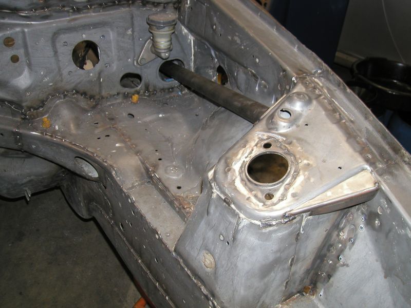

Ashish, what do u think it looks like from below???
GOT SEAM WELD?!
few extra pic of insane amount of seam welding of every possible part of the chassis, firewall bars, shock gussets and control arm brackets boxed/gussets tacked up.
whoops, thought i had more, other pics, can post later.
oh Derek.....yoo hoo....MUHAHAHAJAJAJAHAAAAAAAAAA!
