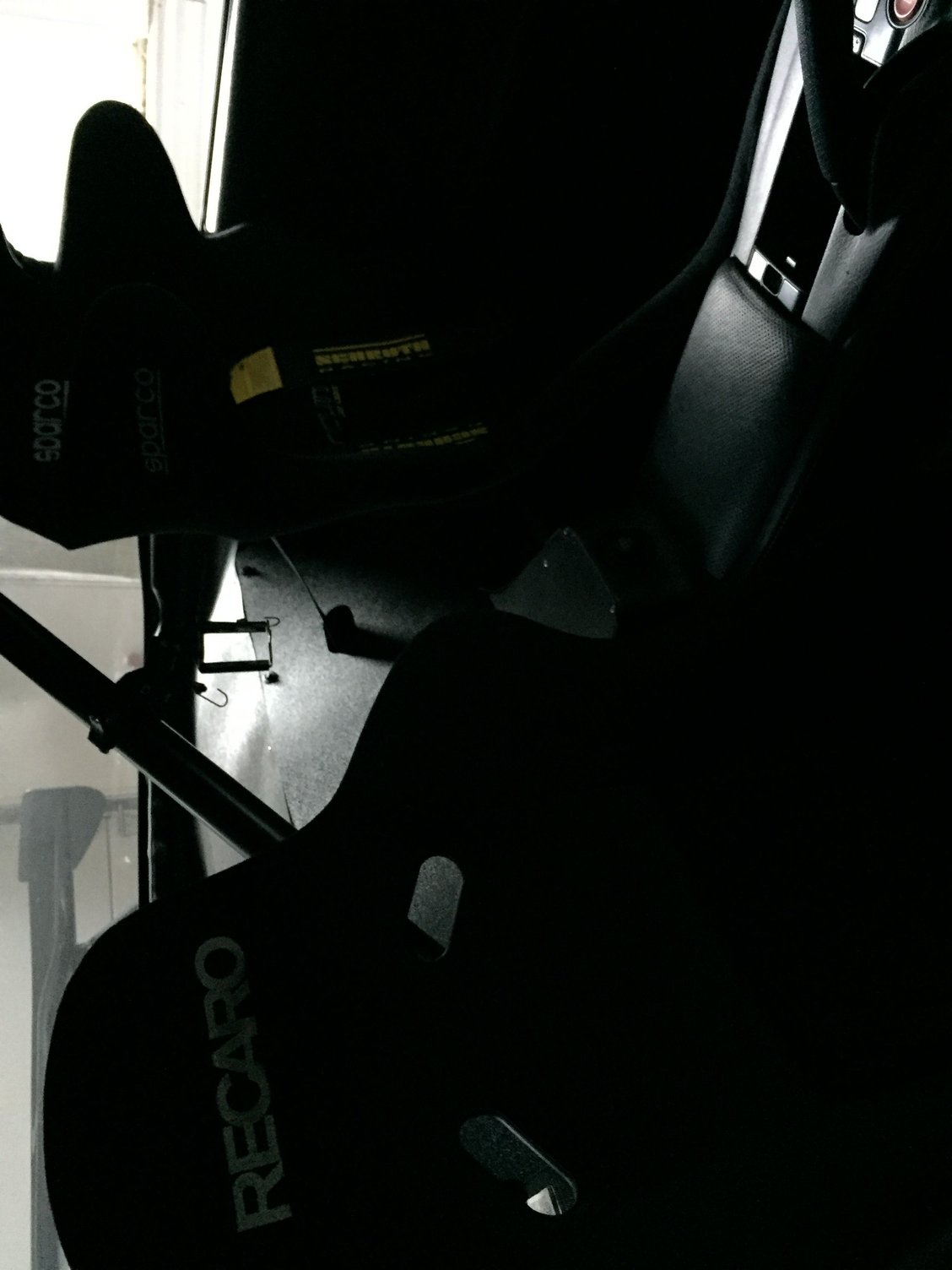

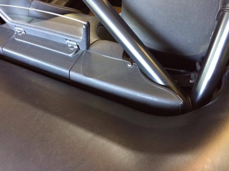

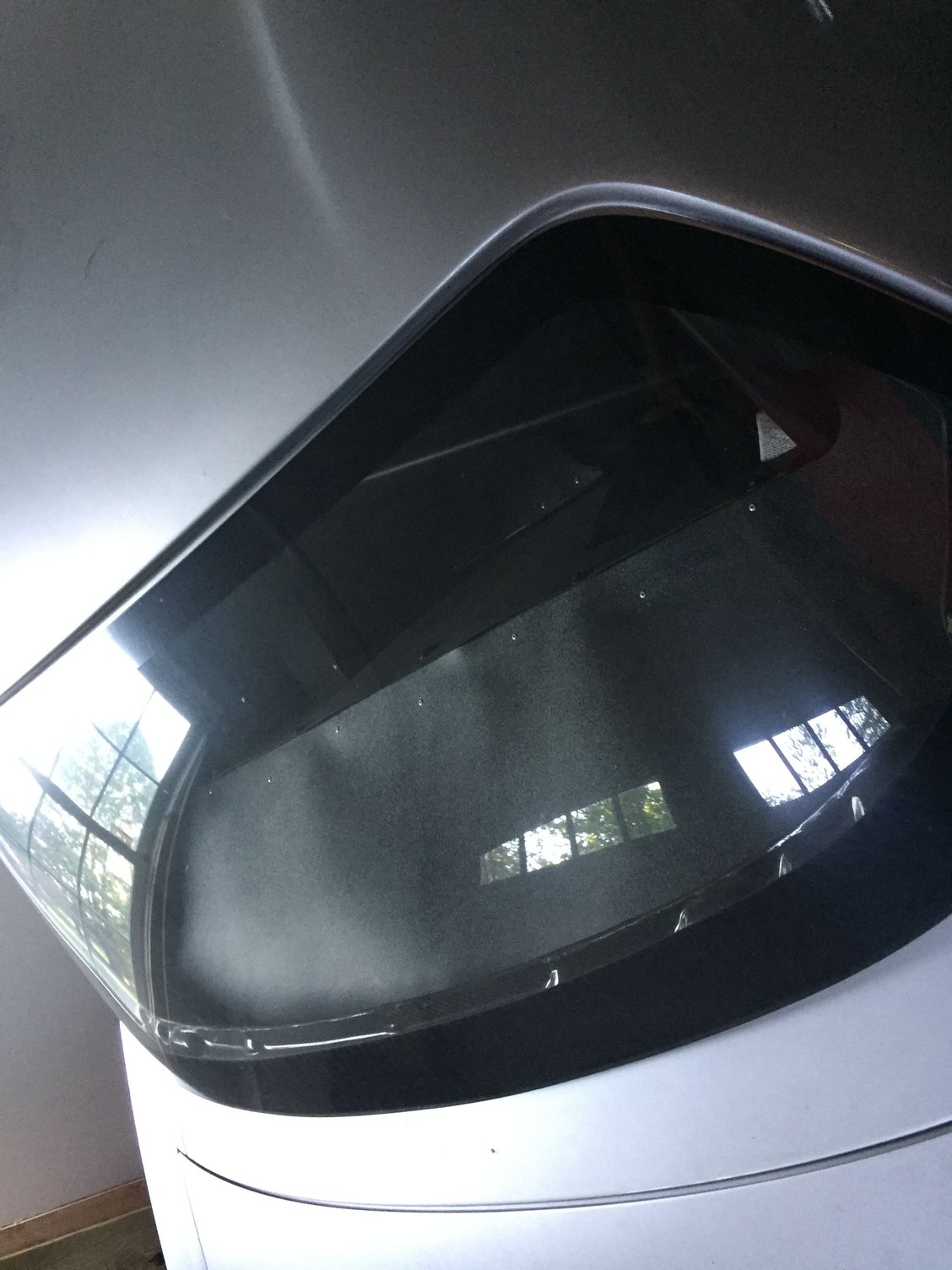

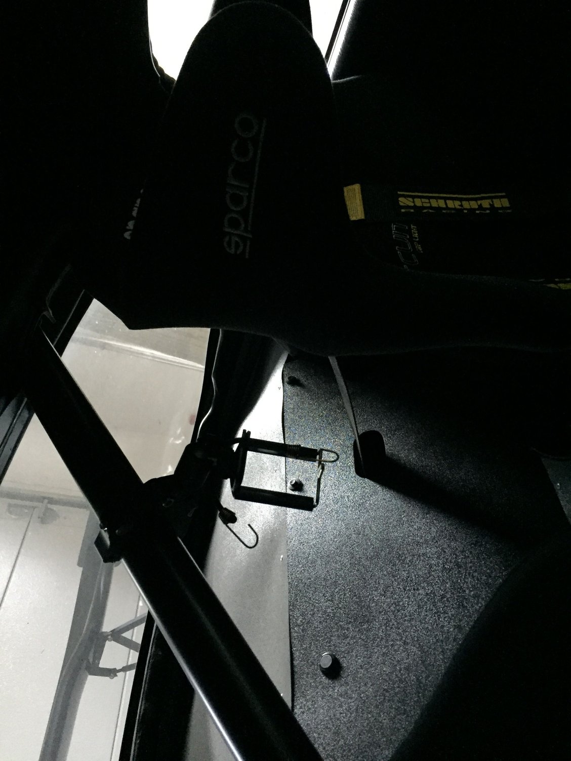

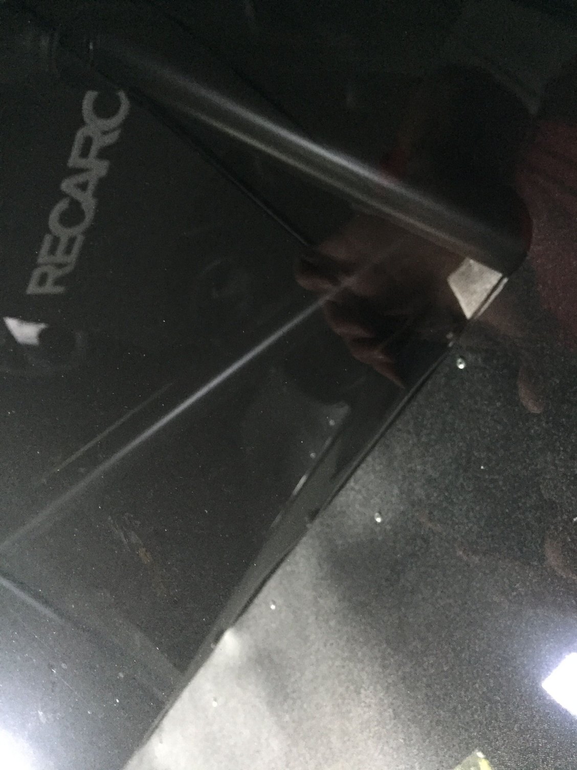

Here are the plastic panels I was talking about that close off the rear of my car. I do not have a soft top or motors. I know they are sort of hard to see....sorry these aren't the greatest photos.....

That's some really nice fabrication work there.
