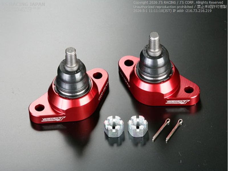

Originally Posted by gptoyz
Curious if any one can elaborate as to the effects of running the version 2 s1 camber joints with 9mm of roll center adjustment built in on a stock suspension cr.
I know if the car is too lowered it shifts the roll center moment past the center line of the car, which is why roll center adjustment is crucial to fixing geometry. Since my car is stock height im guessing this would have the inverse effect of having the roll center moment before the centerline of the car.
If it does have a deleterious effect, is it still worth it for the minimal <1 degree of negative camber gain?
Summarizing, on a stock cr I have gained negative camber at the cost of increasing ride height, increasing center of gravity and shifting roll center.

Originally Posted by s2k_cy
Originally Posted by shind3' timestamp='1400617197' post='23168404
I read through this thread and even though it was hinted at, no one has told the OP to remove the gold RCA spacer to gain some camber back. So let me be the one to do so.
The more you lower the outside end of the control arm, the further inwards you will move it. If you're having trouble visualizing this, imagine detaching the ball joint and letting the LCA pivot all the way down to exaggerate the difference.
Believe me I had that thought but, by removing the spacer that means that my lower arms wouldn't be on a straight line and the lower arms will always be on ''tension''. Yes you are correct by removing the plate for sure I will gain, lets say, another 0,5degree of camber. Also by removing the plate I will loose some of my shock travel and I don't want that. By doing all these that means I will ''upset'' all around the car's geometry.
As I said I agree with you (and most of the guys in here I believe) but the main thing (as a conclusion of this story) is that YOU CANNOT see the ''numbers'' that most of the companies estimates with the s1 rca's. So the only way to get 3,5camber with 6+ caster and to have ''correct'' geometry on your lower arms (depending on the drop ALWAYS) is installing the s2 rca's.
Not to be misunderstand guys but, all the above concussions were made FOR MY CAR, some of you guys I believe you may not agree with me, but as I see it on my car with my little knowledge the s1 don't work FOR MY CRITERIA ON MY CAR.
You will not "upset" the cars geometry by removing the additional 12mm plate. With the plate you will have raised the front roll center and increased the front roll stiffness. Most with a square setup add around 12mm of correction total to the front, you have almost double that, possibly increasing your front roll stiffness more than you want.
Also depending on your coil overs, you may not gain any shock travel with roll center correction. If your ride height is controlled by adjusting a separate lower perch to raise or lower the shock in the lower mount (Ohlins DFV, Tein SRC, etc.), then your travel isn't going to change.
If you install front roll centers and change nothing else you will actually raise the front knuckles and wheels which will lower the car. The upper arm angle will change and will shift the instant center closer to the wheel but the roll center and cg will both come down the same amount (normally you would adjust your coilovers to raise the car back to its original height which would change the angle of the lower arm and raise the roll center). Lowering only the front will increase rake because the rear won't change.
Our two axle Honda S2000 has two roll centers, one aligned over each axle. The roll center is the point the chassis rolls around when it leans around a corner. It's found by extending the axes of the suspension arms until they intersect. A straight line is then drawn from this point back to the tire's contact patch. The intersection of this line and the vehicle centerline is the roll center.

Originally Posted by robrob
and one of the effects of raising roll center is it acts like a spring rate increase in the front roll bar right?
Stiffening the front sway bar or a similar effect sounds like one of the last things I want to do on my stock cr (225/255 setup) as that will increase the understeer up front. At my most recent outing at SOW, the understeer was much much more prominent than Buttonwillow or Thunderhill.
Hmm How can I gain the negative camber adjustment range I'm looking for without affecting the roll center?
Get S2s and shave down the aluminum body?

Thanks for clarifying Rob.
Look for a set of the version 1 S1s without the roll center correction, or look into the other brands. The roll center correction of the version 2 S1 isn't part of the flat plate it is part of the opening that holds the joint.
There are quite a few options out there for increasing the camber adjustment range with no effect on roll center.
The s1s don't solve the problem of enough camber, it's still +|1| negative camber
what difference does it make where the height in the camber joint is taken out, the spacing/overall thickness is what moves the roll center.

Look for a set of the version 1 S2s or whatever it was called.
You can't take height out of the version 2. That is why I mentioned it.
The additional 9mm isn't in the flat plate, it is an offset in the area that the joint mounts. Taking 9mm out of the mounting plate probably isn't a good idea.

You can also have a machine shop make some offset housings for the oem ball joints. Press out stock assemblies from housings and install in machined pieces.
I have seen both.
If memory serves me correct, the ver1 the balljoint is flush with the bottom of the aluminum housing
In ver2 the balljoint is deeper than the aluminum housing
That's why I I believe some of the body can be machined out
